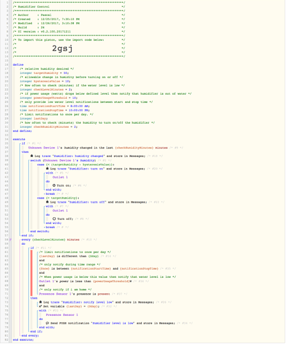

put together my first piston. the humidity change statement using a variable for “in last minutes” is not executing as I would like it to. I can see the humidity changing in the logging, and the switch appears to run, though the logging is not showing
when humidity changes a log entry should be created (debug) leading to humidifier turning on or off
log entry is not being created
12/26/2017, 3:54:39 PM +222ms
+0ms ╔Received event [Home].time = 1514321679845 with a delay of -624ms
+133ms ║RunTime Analysis CS > 14ms > PS > 46ms > PE > 74ms > CE
+136ms ║Runtime (46870 bytes) successfully initialized in 46ms (v0.2.100.20171211) (135ms)
+153ms ║║Evaluating switch with values [[i::4b43b973c0517b8d77a9fa9de789688b::humidity, v:[t:integer, v:35, d::4b43b973c0517b8d77a9fa9de789688b:, a:humidity, i:null, x:false, vt:string]]]
+163ms ║║Calculating (integer) 50 - (integer) 10 >> (integer) 40
+166ms ║║Calculating (null) 0 < (integer) 40 >> (boolean) true
+169ms ║║Comparison (integer) 35 is (boolean) true = false (2ms)
+182ms ║║Calculating (null) 0 > (integer) 50 >> (boolean) false
+185ms ║║Comparison (integer) 35 is (boolean) false = false (2ms)
+206ms ║║Comparison (integer) 0 is_different_than (integer) 26 = true (1ms)
+208ms ║║Condition #14 evaluated true (6ms)
+219ms ║║Comparison (datetime) 1514321679432 is_between (time) 28800000 … (time) 79200000 = true (6ms)
+221ms ║║Condition #35 evaluated true (12ms)
+232ms ║║Comparison (decimal) 28.6 is_less_than (integer) 10 = false (2ms)
+233ms ║║Condition #36 evaluated false (11ms)
+234ms ║║Condition group #11 evaluated false (state did not change) (33ms)
+238ms ║╚Execution stage complete. (100ms)
+241ms ║Setting up scheduled job for Tue, Dec 26 2017 @ 3:56:39 PM EST (in 120.385s)
+253ms ╚Event processed successfully (252ms)

12/26/2017, 3:50:38 PM +203ms
+0ms ╔Received event [Home].time = 1514321439845 with a delay of -1643ms
+115ms ║RunTime Analysis CS > 12ms > PS > 29ms > PE > 75ms > CE
+118ms ║Runtime (46871 bytes) successfully initialized in 29ms (v0.2.100.20171211) (117ms)
+138ms ║║Evaluating switch with values [[i::4b43b973c0517b8d77a9fa9de789688b::humidity, v:[t:integer, v:34, d::4b43b973c0517b8d77a9fa9de789688b:, a:humidity, i:null, x:false, vt:string]]]
+148ms ║║Calculating (integer) 50 - (integer) 10 >> (integer) 40
+151ms ║║Calculating (null) 0 < (integer) 40 >> (boolean) true
+155ms ║║Comparison (integer) 34 is (boolean) true = false (2ms)
+168ms ║║Calculating (null) 0 > (integer) 50 >> (boolean) false
+172ms ║║Comparison (integer) 34 is (boolean) false = false (2ms)
+195ms ║║Comparison (integer) 0 is_different_than (integer) 26 = true (2ms)
+197ms ║║Condition #14 evaluated true (7ms)
+213ms ║║Comparison (datetime) 1514321438402 is_between (time) 28800000 … (time) 79200000 = true (10ms)
+215ms ║║Condition #35 evaluated true (17ms)
+227ms ║║Comparison (decimal) 28.4 is_less_than (integer) 10 = false (2ms)
+228ms ║║Condition #36 evaluated false (12ms)
+229ms ║║Condition group #11 evaluated false (state did not change) (40ms)
+233ms ║╚Execution stage complete. (114ms)
+235ms ║Setting up scheduled job for Tue, Dec 26 2017 @ 3:52:39 PM EST (in 121.408s)
+243ms ╚Event processed successfully (243ms)
12/26/2017, 3:48:39 PM +202ms
+0ms ╔Received event [Home].time = 1514321319845 with a delay of -644ms
+161ms ║RunTime Analysis CS > 59ms > PS > 38ms > PE > 60ms > CE
+164ms ║Runtime (46870 bytes) successfully initialized in 38ms (v0.2.100.20171211) (163ms)
+182ms ║║Evaluating switch with values [[i::4b43b973c0517b8d77a9fa9de789688b::humidity, v:[t:integer, v:32, d::4b43b973c0517b8d77a9fa9de789688b:, a:humidity, i:null, x:false, vt:string]]]
+191ms ║║Calculating (integer) 50 - (integer) 10 >> (integer) 40
+194ms ║║Calculating (null) 0 < (integer) 40 >> (boolean) true
+201ms ║║Comparison (integer) 32 is (boolean) true = false (2ms)
+213ms ║║Calculating (null) 0 > (integer) 50 >> (boolean) false
+216ms ║║Comparison (integer) 32 is (boolean) false = false (1ms)
+250ms ║║Comparison (integer) 0 is_different_than (integer) 26 = true (8ms)
+252ms ║║Condition #14 evaluated true (20ms)
+266ms ║║Comparison (datetime) 1514321319455 is_between (time) 28800000 … (time) 79200000 = true (9ms)
+268ms ║║Condition #35 evaluated true (16ms)
+281ms ║║Comparison (decimal) 28.4 is_less_than (integer) 10 = false (5ms)
+282ms ║║Condition #36 evaluated false (13ms)
+283ms ║║Condition group #11 evaluated false (state did not change) (52ms)
+287ms ║║Fast executing schedules, waiting for 357ms to sync up
+660ms ║║Evaluating switch with values [[i::4b43b973c0517b8d77a9fa9de789688b::humidity, v:[t:integer, v:32, d::4b43b973c0517b8d77a9fa9de789688b:, a:humidity, i:null, x:false, vt:string]]]
+669ms ║║Calculating (integer) 50 - (integer) 10 >> (integer) 40
+672ms ║║Calculating (null) 0 < (integer) 40 >> (boolean) true
+675ms ║║Comparison (integer) 32 is (boolean) true = false (1ms)
+686ms ║║Calculating (null) 0 > (integer) 50 >> (boolean) false
+689ms ║║Comparison (integer) 32 is (boolean) false = false (1ms)
+709ms ║║Comparison (integer) 0 is_different_than (integer) 26 = true (2ms)
+710ms ║║Condition #14 evaluated true (6ms)
+720ms ║║Comparison (datetime) 1514321319914 is_between (time) 28800000 … (time) 79200000 = true (5ms)
+721ms ║║Condition #35 evaluated true (10ms)
+731ms ║║Comparison (decimal) 28.4 is_less_than (integer) 10 = false (1ms)
+732ms ║║Condition #36 evaluated false (10ms)
+733ms ║║Condition group #11 evaluated false (state did not change) (28ms)
+735ms ║╚Execution stage complete. (570ms)
+741ms ║Setting up scheduled job for Tue, Dec 26 2017 @ 3:50:39 PM EST (in 119.907s)
+749ms ╚Event processed successfully (749ms)
