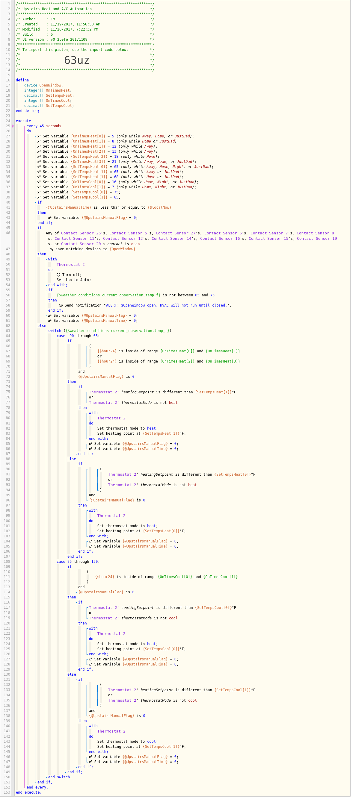

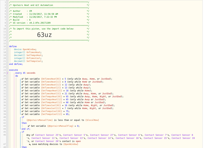

I decided to split it into 2 separate pistons. One for each thermostat. I kept the Manual Set piston unchanged.
Here is one of my new thermostat pistons. They are both the same just reference different thermostats and have different time and temp settings at the top. I’m sure that I’m still doing some things wrong and would love any suggestions. But it is lot easier to read and manage now at least.
piston looks cool, what does it do?
It automates the heat and cool based on time, mode, and outside temperature. It will not turn the heat or cooling on if the outside temp is between 65-70F. If the outside temp is not in that range (either higher or lower) it will turn off the furnace or A/C and send a notification of which window is open.
I also have another piston that works with this one that allows me to track if anyone manually changes the temp on the thermostat. It sets a timer and resumes the automatic setting after 1 hour.
