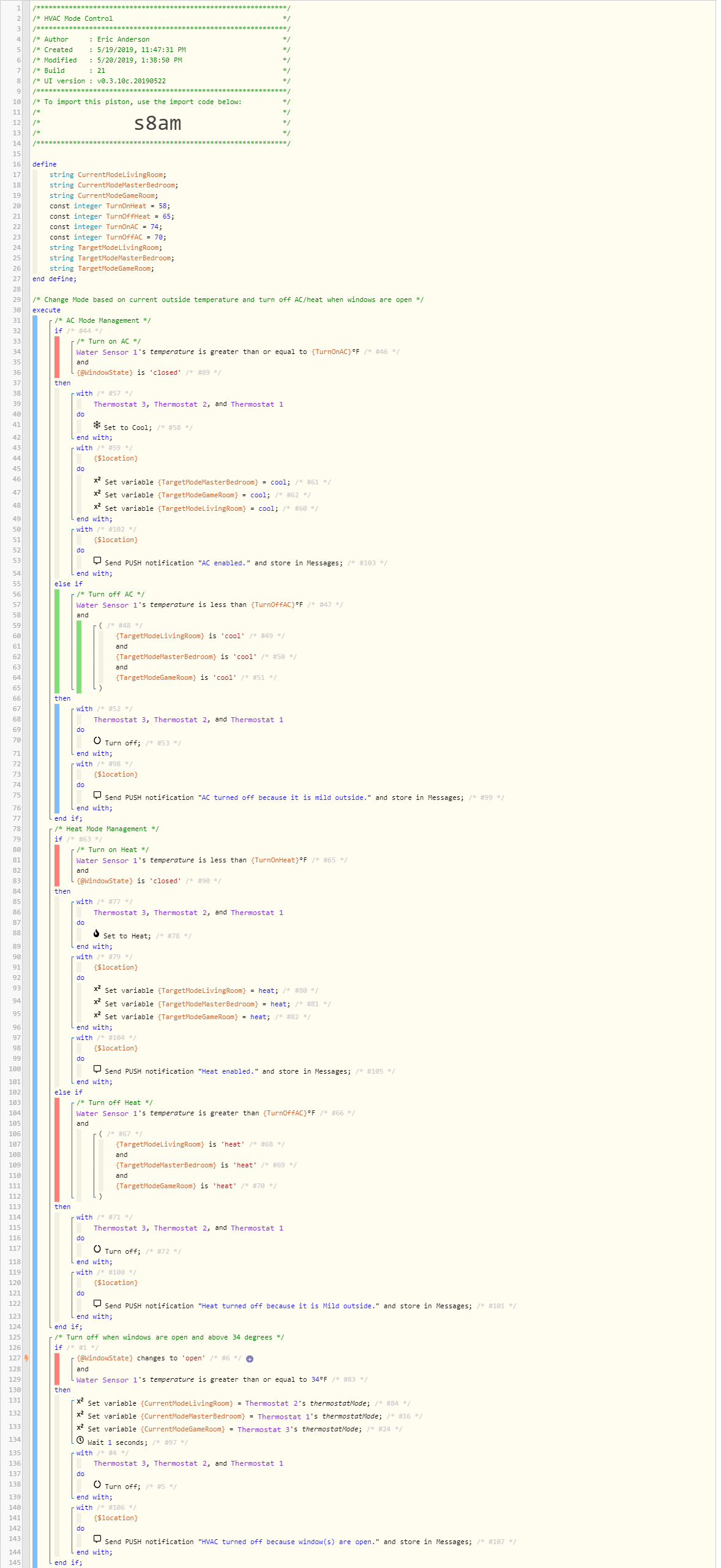

HVAC mode control based on outside temperature

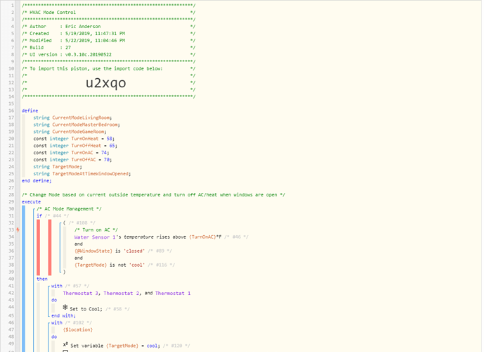

It appears my piston hasn’t subscribed to the temperature rising above 74, no trigger. My thermostats did not return to cooling mode after leaving the windows open over night. I closed the windows in the morning, before the outside temp rose above 74, and it ran the temperature check which if failed because it was 69.8 outside. The piston never ran again. So do i need to change line 31 to “rises above”? but will it fire if the temp is above 74 outside when the windows are closed.
I expected the cooling mode to return to cooling when the temperature rised above 74
thermostats were off when i came home after work.

will this fix it?
My freetime is scarce the next few days, but generally, I try to use a trigger to fire off the piston, and conditions to control the flow afterwards. In your “s8am” piston, the only time the piston will fire is when {@WindowState} changes to open.

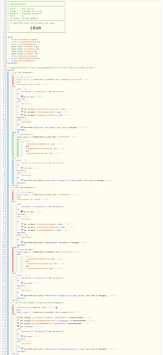

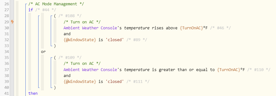

with my edit it just keeps firing on the rises above… one would think it would only look for the rises above and stop… but it just keeps firing repeatedly, the push message is ringing my phone off the hook.

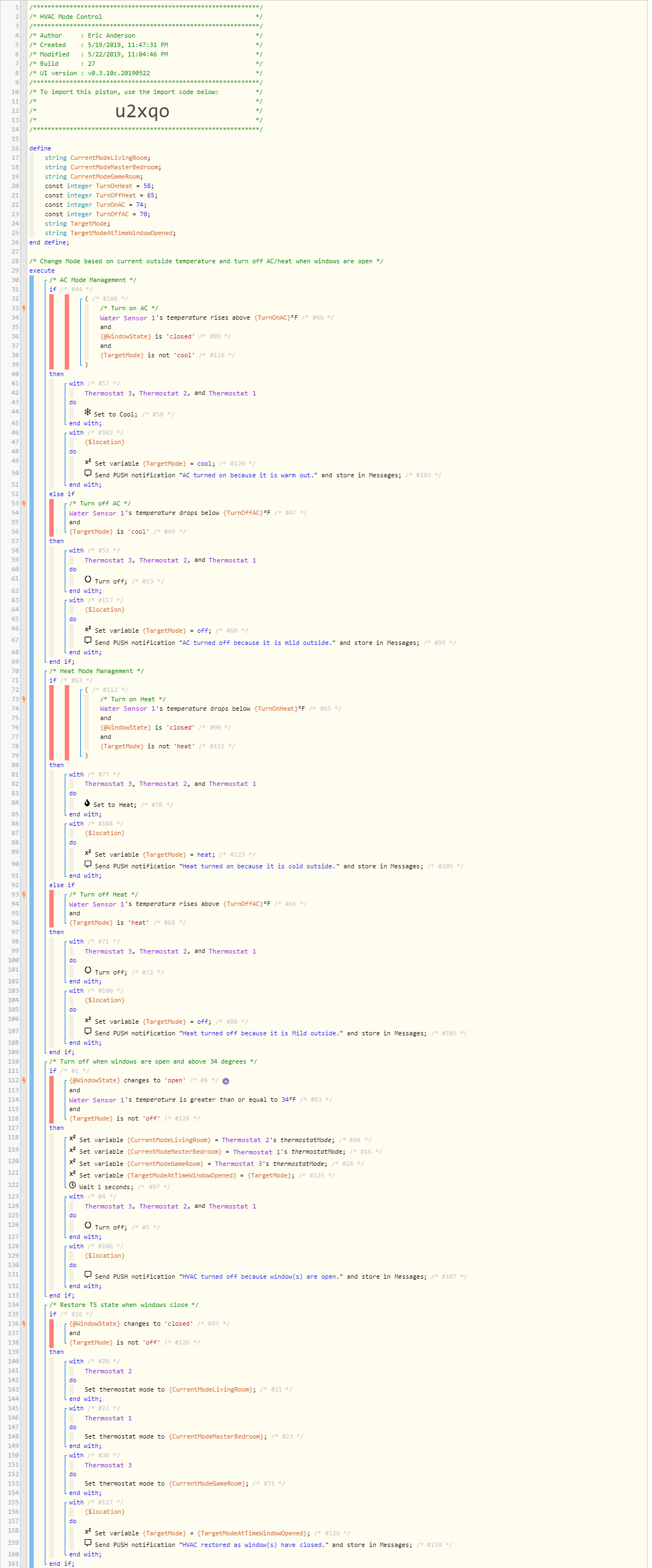

perhaps this is the solution…
It might help to make the trigger periodic (check every 15 minutes or every half-hour). Then check the conditions and make changes accordingly. Only send messages if a change in thermostat control is made.
Unless you have thermal conditions like Alderaan,
you should be able to pick up temperature shifts in time to react appropriately without wasting too much heating or cooling.
Would be nice to let the temperature in house rise above the normal set point when a cold front is going to be rolling in soon.
Right now the trigger is running about every 12 to 20 minutes. My SmartThings app only updates every two minutes from my ambient weather data.
