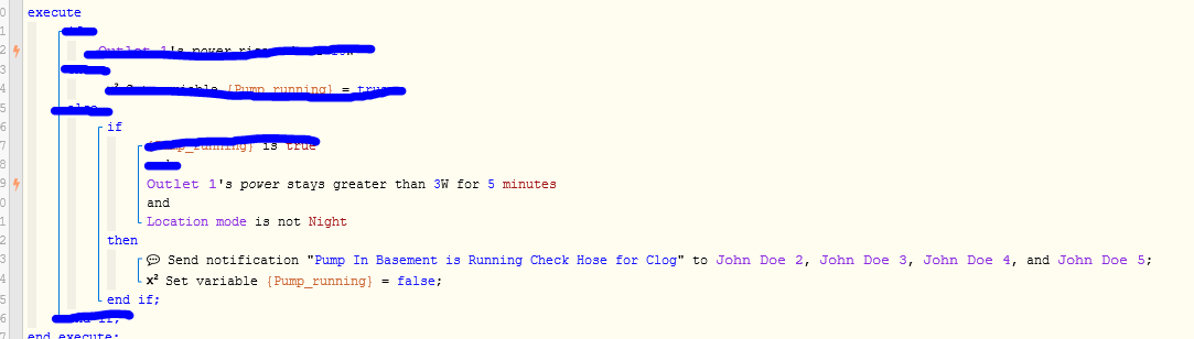

So far I used a “Laundry’s Done” Piston I found and am using for my washing machine and have modified it. I’m just getting stuck on how to change the variable at the end where is the pump actually shuts off to reset the variable and send no notification.

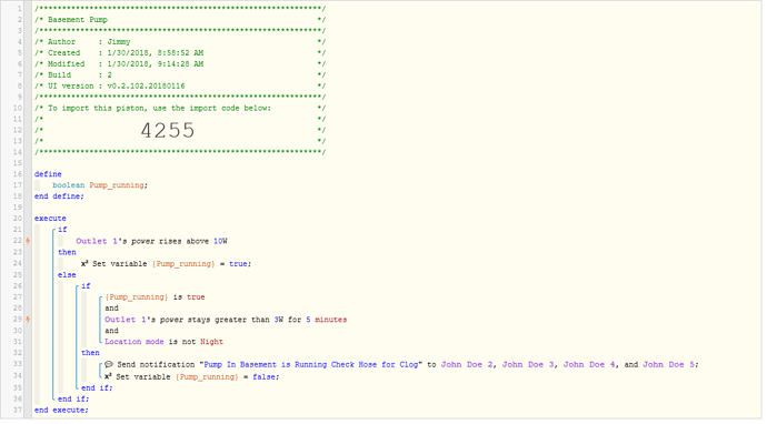

Thanks for the heads up. I guess I was just over complicating things here. I’ve read up on some of the energy monitoring pistons and the common thread was to add a variable to avoid false alarms. I do think I may have figured it out still using the variable but will most likely just change it to the simple piston you recommend, I prefer easy peaze.

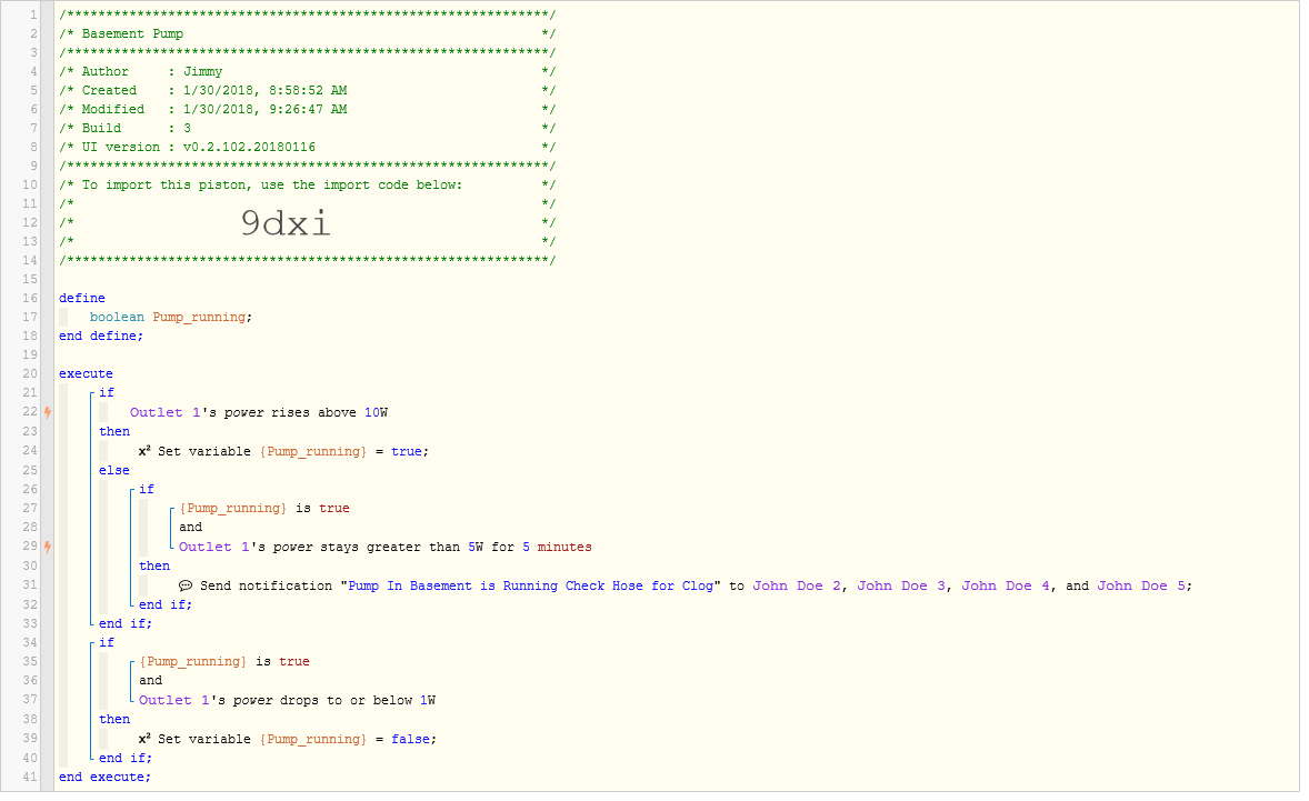

Could take a quick peek at this and see if it would work as I was looking for with the variables? I just want to make sure I’m getting a grasp of this whole WebCoRe thing :slight_smile:

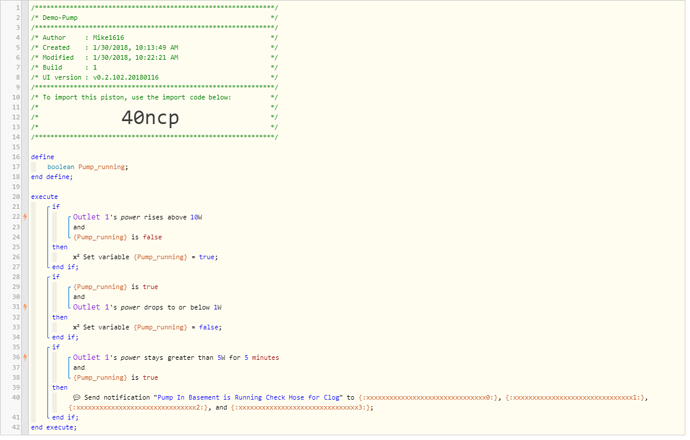

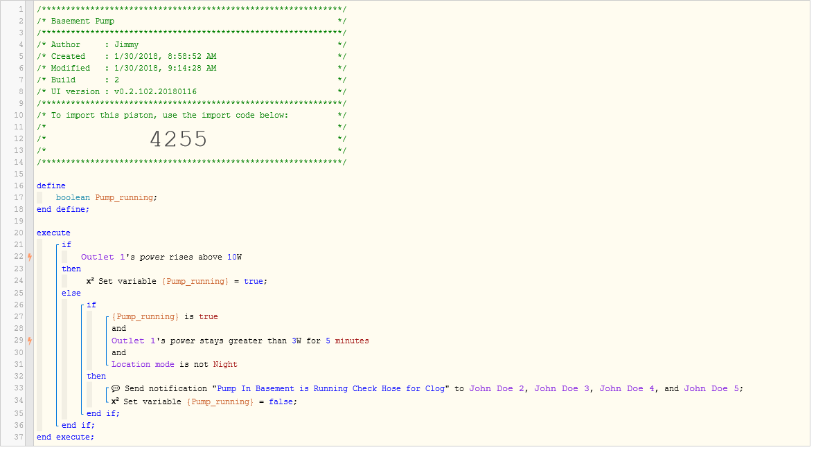

But anyway…let’s proceed with what you want to do. What you have there won’t work. You can’t tuck the Notification IF statement inside where you have it as it then relies on “rises above” to be true…which it probably won’t be in five minutes. It will just be at a certain power level.

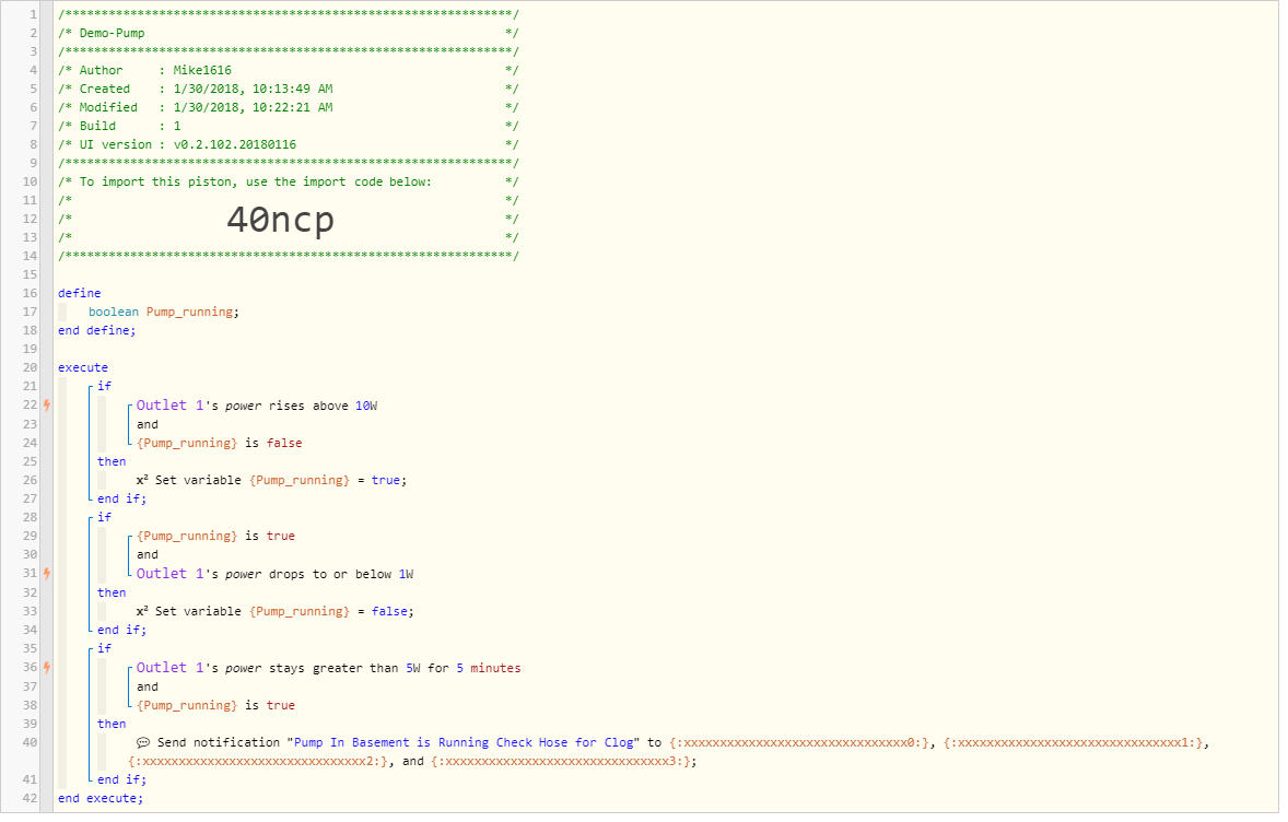

If you really want to use the variable to do this…then you really need to do it the way I show below. All three statements on their own. Three different triggers, all happily playing together nicely.
