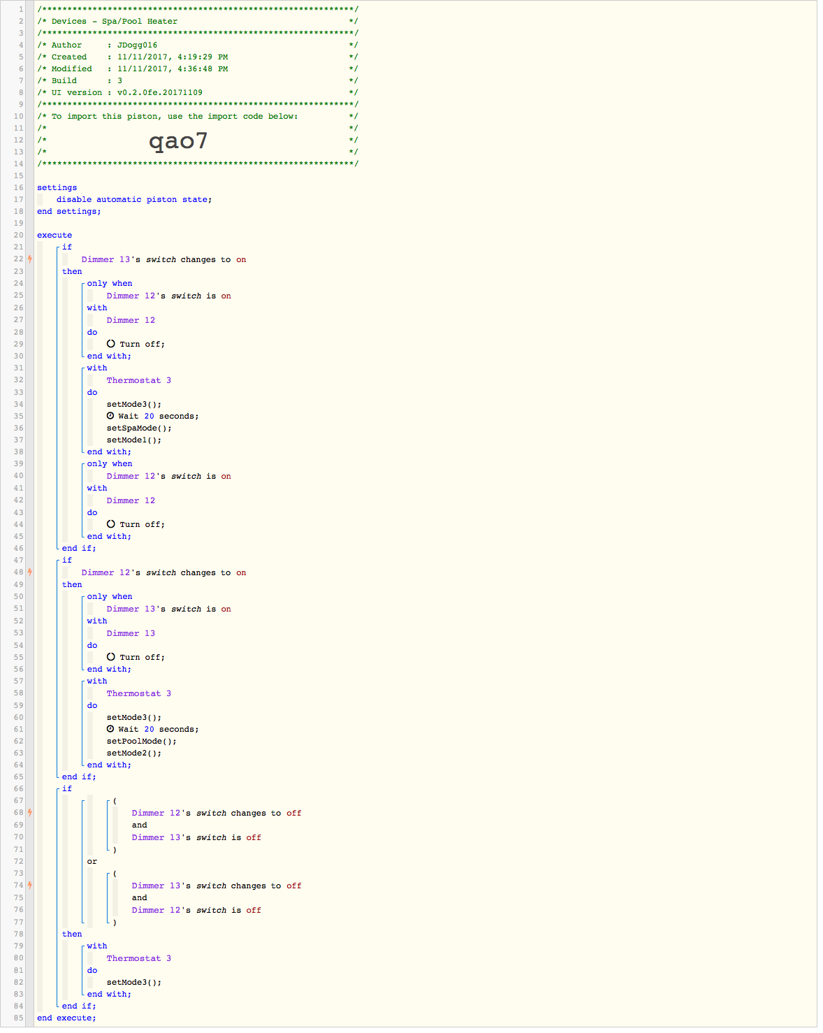

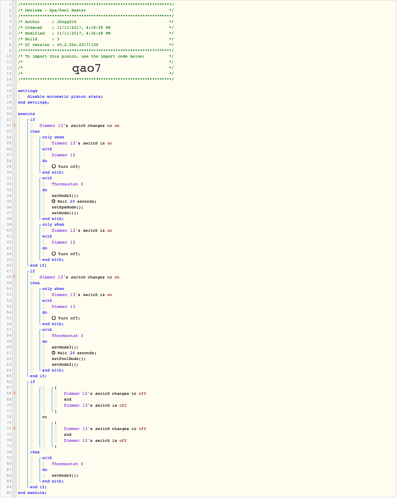

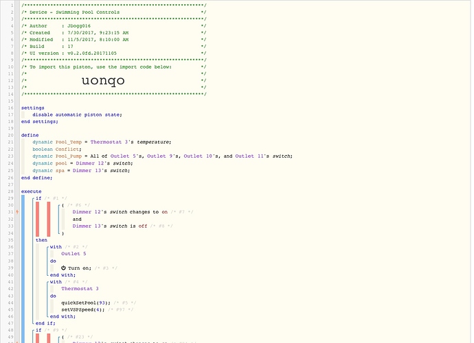

I have to be honest, I need to restructure this entire piston.
I have a z-wave pool pump and heater which can also control my spa. Using the ST Device IDE takes 3-5 steps to turn on the pool heater or hot tub which does not meet my approval or the wife approval.
What I would like to happen is to hit a switch (virtual) to turn on the pool heater and set it to a temperature and hit a switch (virtual) to turn on the spa.
The challenge is two-fold… I cannot have both virtual switches on simultaneously AND I have to turn off the pool pump to switch to SPA mode as to not damage the pool pump.
Simply put, I overbuilt this piston with too many functions and need advice on organize the piston to better automate the pool. RIght now turning on the pool heater or spa does nothing.
