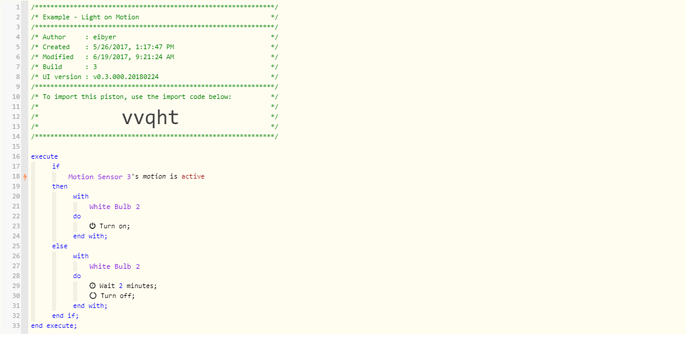

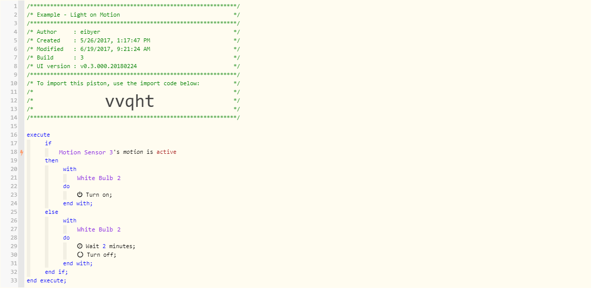

Try it in this format.
Motion Activated Light OFF/ON
Thank you. I will give it a shot.
That did fix the motion/no motion issue. Now I need to get the other conditions to reset the piston. :slight_smile: I’m getting closer. Thank you for the assistance.
No problem, post back if you have any issues.
