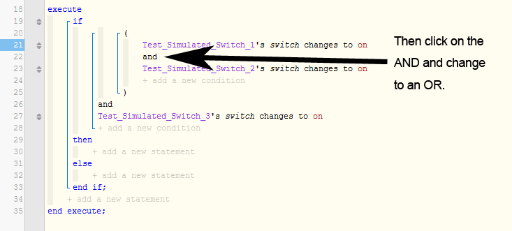

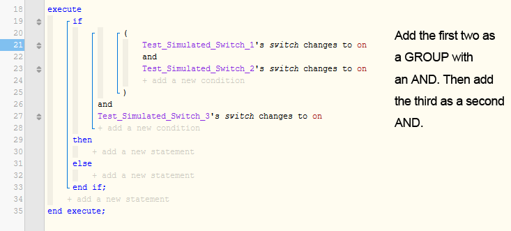

Yes, I have also had a little difficulty figuring this one out. Maybe someone has a better option, but here is how I do it.
Pantheon explained well (I didn’t know how it was done either, thank you)

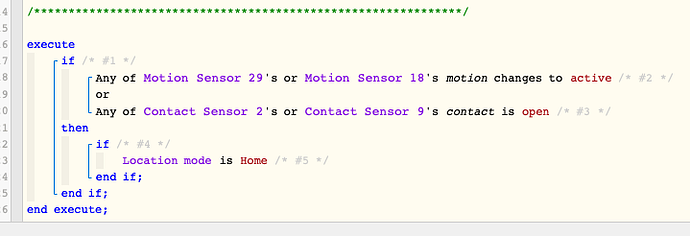

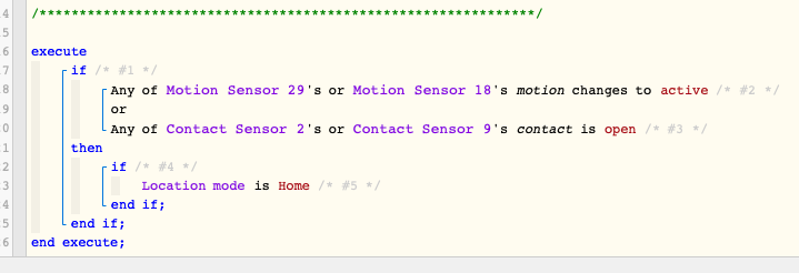

Since I didn’t know, I was using something like this so far, maybe it works for you…
IF within IF
I am a fan of Ike’s method since that gives me more granular control, without adding more triggers.

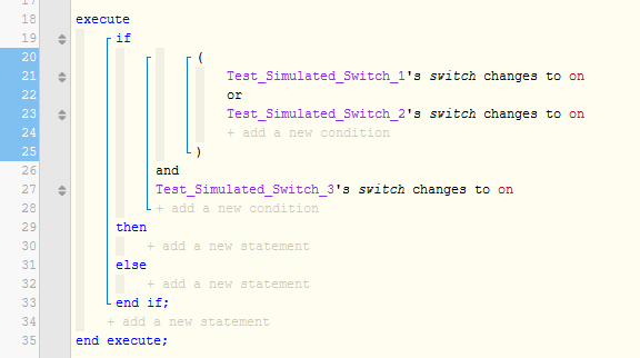

Pro Tip:
This structure works if the first two match each other. (both triggers, or both conditions)…
The third one must be a condition…
