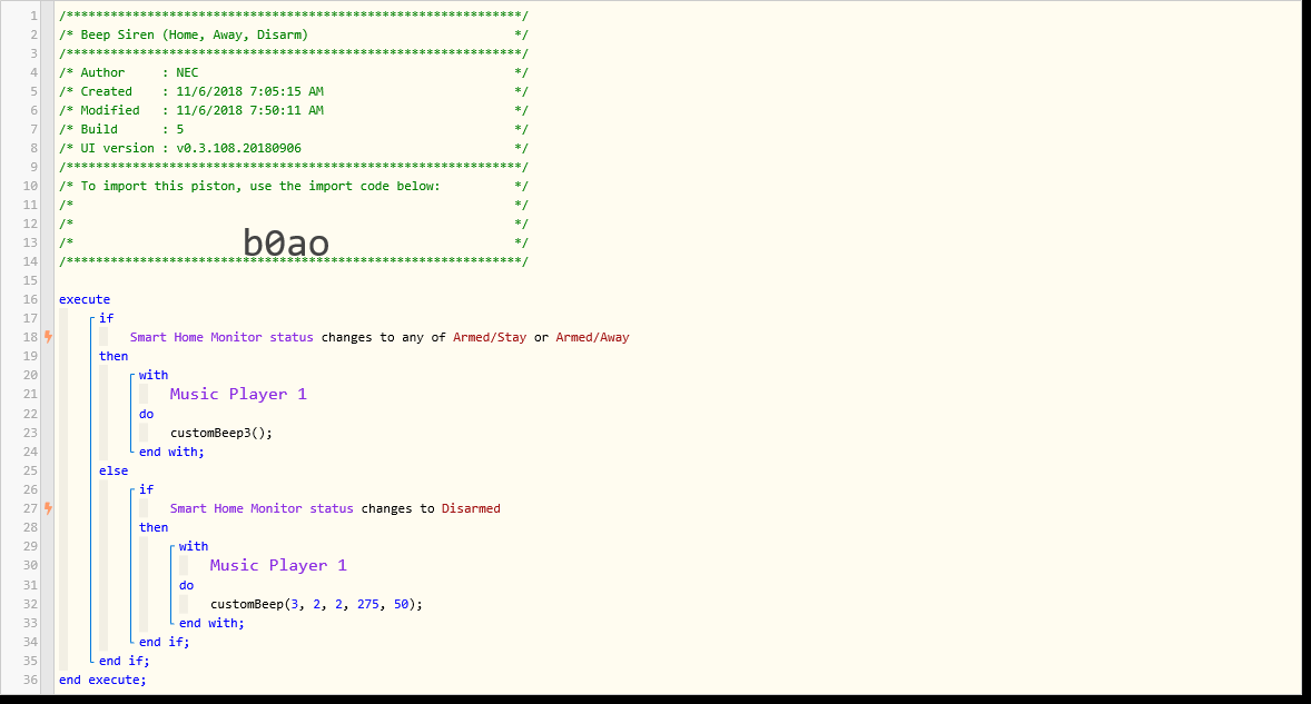

When I try to run the simple piston below, the IF commands run fine but the ELSE commands never do. I can only get the commands in the ELSE section to run if I create a separate piston. I am trying to be as efficient and not create separate pistons if I don’t have to.
I want the piston to give one beep if I SHM changes to Armed/Stay or Armed/Away modes and a custom beep if it changes to Disarmed.
The beep happens when I put SHM in either of the Armed/Stay or Armed/Away modes but nothing when I change it to Disarmed.
Create two individual IF blocks instead of embedding the second IF block within the ELSE statement :slight_smile:
Or remove the IF block from the ELSE statement and just put the action for the music player.
Works great now! Thanks so much!!!
