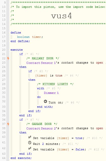

I tend to use variables for this… Maybe something like:
Note:
Not seen in this image, but the last WITH block has the Task Cancellation Policy set to Never for this to work

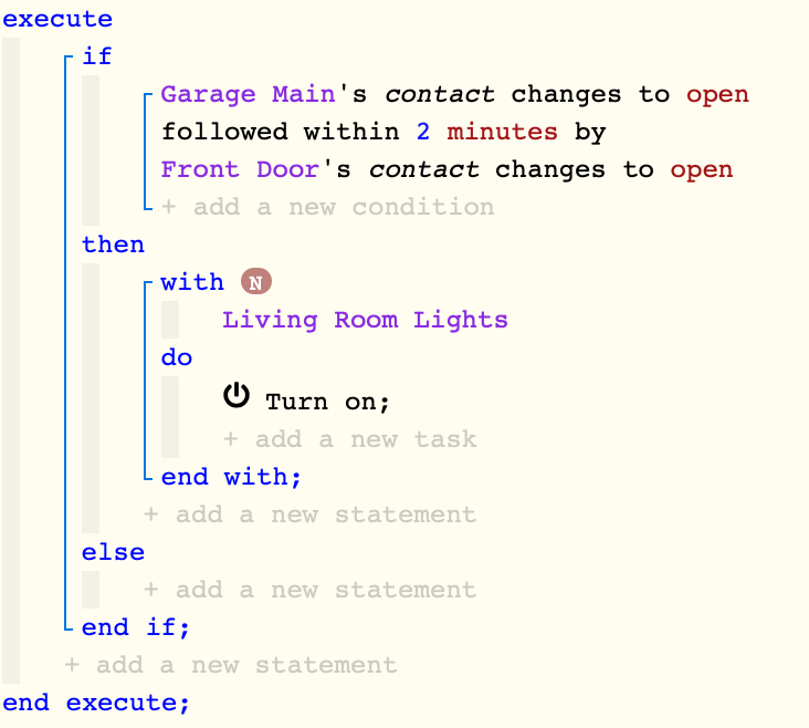

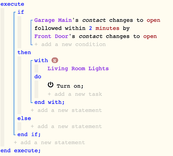

Use the “followed within X minutes” with the group feature.
If
garage door changes to open
followed within 2 minutes by
Hallway door open
then
Turn on kitchen lights (task cancellation never)

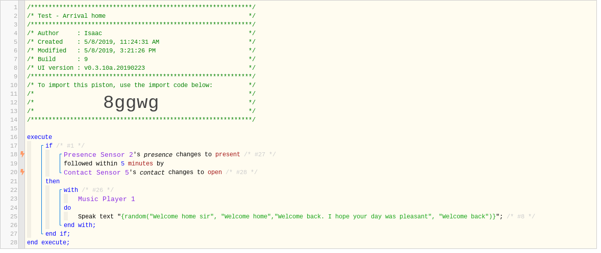

I’m trying to do something similar with a pretty simple “Welcome Home” piston and the ‘followed with X minutes’ does not seem to work reliably.
What my desired result is that I arrive home, park my car, and when I walk in the door, this triggers the announcement.
I’ve been testing this and I’ve noticed that it only works every other time.
Test #1: Doesn’t work
Test #2: Works!
Test #3: Doesn’t work
Test #4: Works!
I agree 100%, which is why I usually take full control of that sequence this way.
I’m a bit of a newbie and was hoping someone would chime with a better use of ‘followed by X minutes’ but if the variable way is more reliable; looks like it time to learn something new.
I agree with you. Maybe someone has found a reliable way to utilize that command.
I’d love to learn something new!
Thanks for your assistance I just imported your example and rearranged it a bit to make it easier for me to read and it seems to be working reliably.
Now I’m thinking of what else I can make using variables. Certainly is simpler and more consistent than trying to figure out why “Followed by X minutes” wasn’t working.
