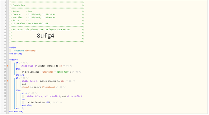

I’m trying to create a poor-man’s ‘double-tap’ piston, but seem to have run into something that’s working against me. I have the the time limit set to two seconds right now, but for the life of me I can’t figure out why this statement is evaluating false:

I deleted it once I couldn’t get the IF statement to produce the correct outcome. I thought that was more of a webCoRe thing in my original post; I didn’t think I could write a piston that would make that evaluate as false.
It wasn’t a terribly complex piston though, it was:
If switch turns on, set variable ‘timestamp’ to $now + 4000.
If the same switch turns off AND $now is before ‘timestamp’ (essentially capturing an on-off cycle in 4 seconds, at least that was the goal)… then turn on all first floor lights.
All the parameters in the log satisfied the IF statement, but it evaluated false.

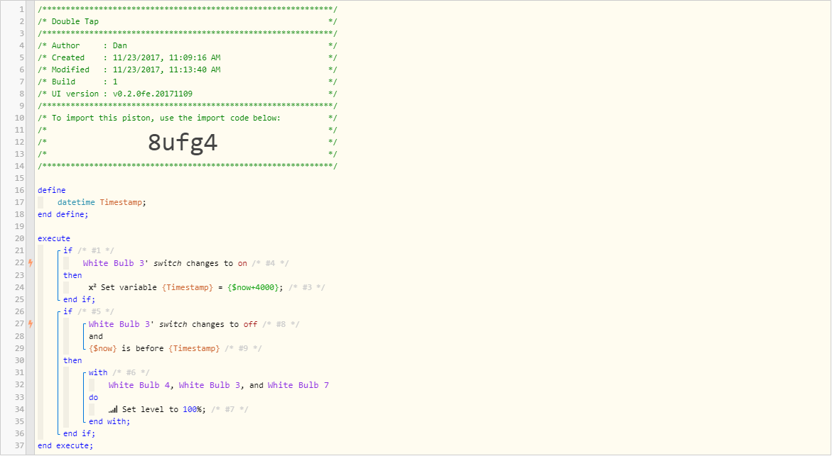

Here’s a recreation of it… I think it took me about as much time as it did to type it above! :slight_smile:

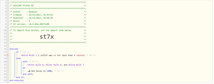

Is this what you are trying to achieve?
Yeah, that should work too… never used the “was” comparison before so that didn’t even cross my mind. Thanks!
