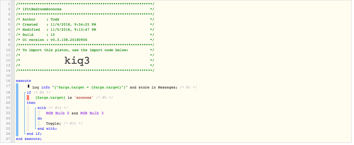

I am using $arg to pass some information to the piston via a query parameter in the direct URL to the piston. This is just adding ?target= to the URL. Based on the value of target the piston does various things.
All is well when the URL is loaded directly in the browser. When called (GET) from a Webhook via IFTT things don’t work. Everything is identical in the logs between the two ways of calling the URL, but you see this difference:
Webhook
Comparison (dynamic) sconces is (string) sconces = false (2ms)
^^ Isn’t that wrong??
URL
Comparison (dynamic) sconces is (string) sconces = true (2ms)
^^ this is evaluating to false

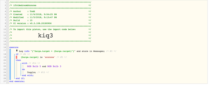

**4)
Via Webhook
11/5/2018, 9:15:14 PM +52ms
+0ms ╔Received event [Moreland].execute = 18.232.81.157 with a delay of 46ms
+100ms ║RunTime Analysis CS > 18ms > PS > 67ms > PE > 16ms > CE
+102ms ║Runtime (37279 bytes) successfully initialized in 67ms (v0.3.108.20180906) (101ms)
+110ms ║║Cancelling statement #1's schedules...
+120ms ║║Calculating (string) $args.target = + (string) sconces >> (string) $args.target = sconces
+123ms ║║Calculating (string) $args.target = sconces + (string) >> (string) $args.target = sconces
+128ms ║║$args.target = sconces
+131ms ║║Executed virtual command log (4ms)
+141ms ║║Comparison (dynamic) sconces is (string) sconces = false (2ms)
+143ms ║║Cancelling condition #5's schedules...
+144ms ║║Condition #5 evaluated false (8ms)
+145ms ║║Cancelling condition #4's schedules...
+146ms ║║Condition group #4 evaluated false (state changed) (12ms)
+149ms ║╚Execution stage complete. (46ms)
Direct URL
+1ms ╔Received event [Moreland].execute = 173.49.151.15 with a delay of 38ms
+108ms ║RunTime Analysis CS > 29ms > PS > 66ms > PE > 13ms > CE
+111ms ║Runtime (37279 bytes) successfully initialized in 66ms (v0.3.108.20180906) (108ms)
+118ms ║║Cancelling statement #1's schedules...
+128ms ║║Calculating (string) $args.target = + (string) sconces >> (string) $args.target = sconces
+132ms ║║Calculating (string) $args.target = sconces + (string) >> (string) $args.target = sconces
+136ms ║║$args.target = sconces
+140ms ║║Executed virtual command log (4ms)
+149ms ║║Comparison (dynamic) sconces is (string) sconces = true (2ms)
+151ms ║║Condition #5 evaluated true (8ms)
+152ms ║║Condition group #4 evaluated true (state did not change) (9ms)
+155ms ║║Cancelling statement #14's schedules...
+179ms ║║Executed physical command [BR Left Sconce].off() (15ms)
+180ms ║║Executed virtual command [BR Left Sconce].toggle (21ms)
+197ms ║║Executed physical command [BR Right Sconce].off() (10ms)
+198ms ║║Executed virtual command [BR Right Sconce].toggle (16ms)
+201ms ║╚Execution stage complete. (90ms)
+203ms ╚Event processed successfully (202ms)
