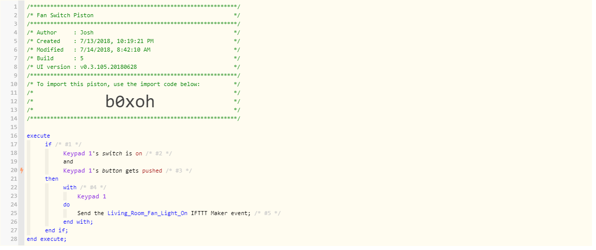

I’ve tweaked it to try and leverage doubletap. It works using the smartthings app but the device itself isn’t doing the doubletap, which is odd.
The trigger for this piston is keypad 1 button getting pushed. Why do you also have the condition that keypad 1 is on?
Does keypad 1 report a condition of on?
So this is a fan and the lights and fan itself work on the same switch. The bond device can separate these hence I’m using ifttt. I want to be able to operate the lights independently with the double tap functionality.
Your piston is looking for the action “pushed” not double tapped.

What DTH are you using for the GE switch? There should be two buttons, one for double up and one for double down. Your piston looks like the switch only has one button. That is a little odd to me. Are you sure you have the right DTH?
Also, the device will not report the button being pushed if it’s already on. You HAVE to use the double tap.

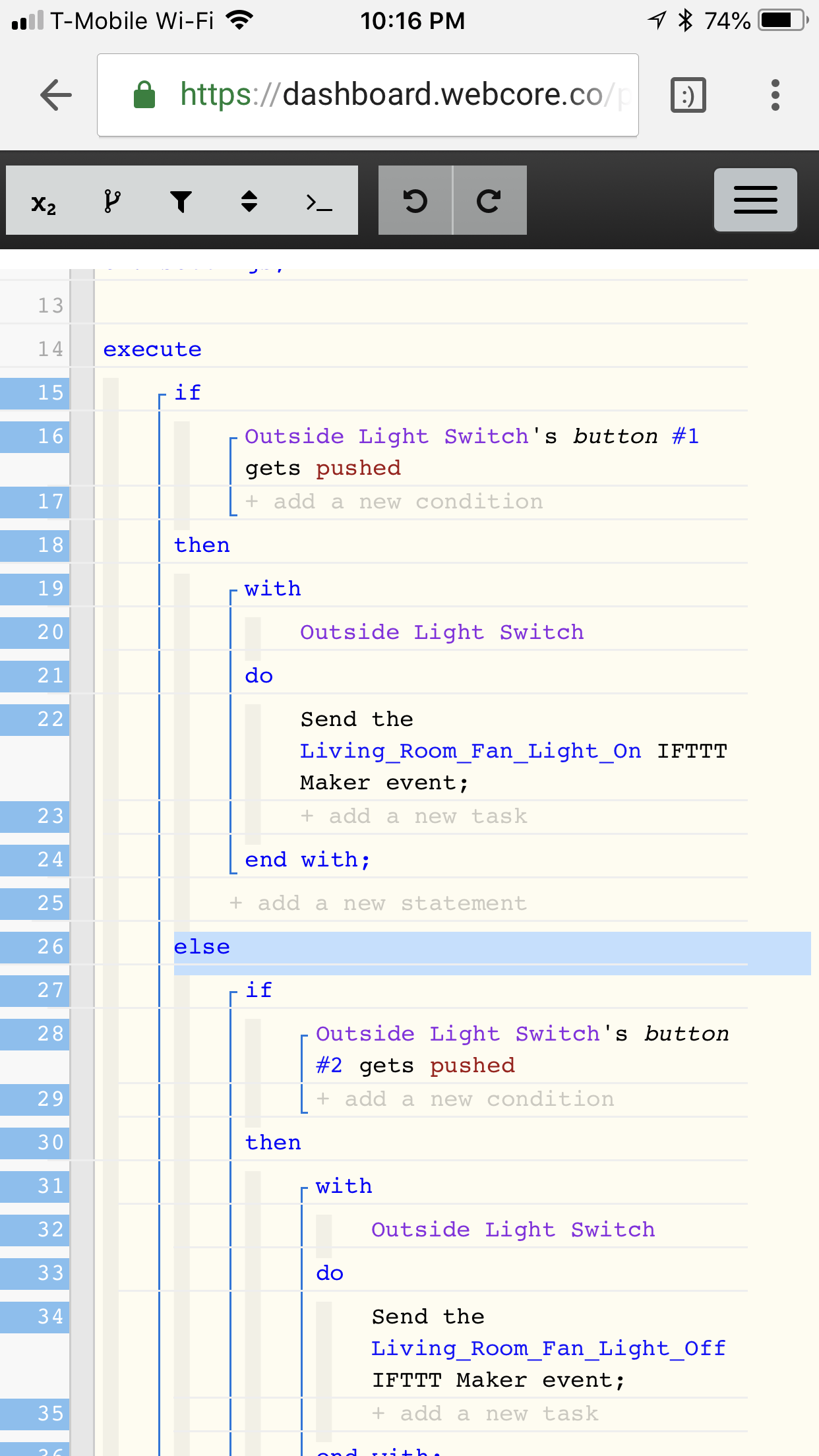

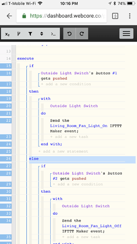

So I created this piston last night using my another switch location. It works without issue so it’s definitely a dth issue with regards to the ge fan switch. I read that the fan switch does support double tap using nuttytrees dth so I’m definitely at a loss

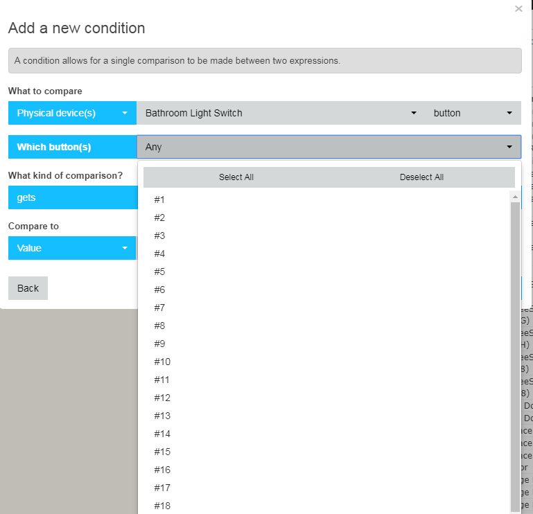

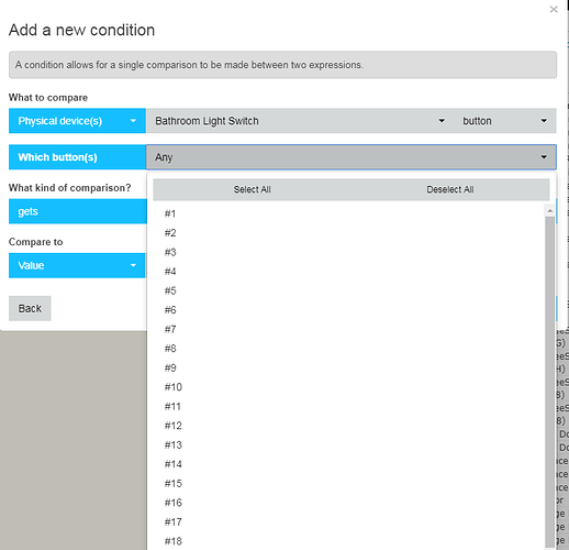

In a related question I tried using the DTH on a GE Zwave On/Off Toggle and I see this as button choices:
