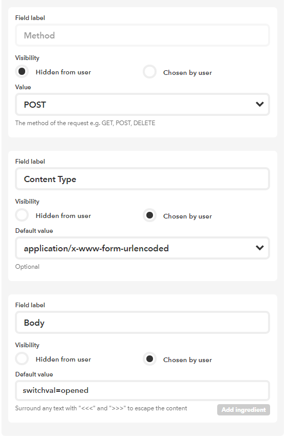

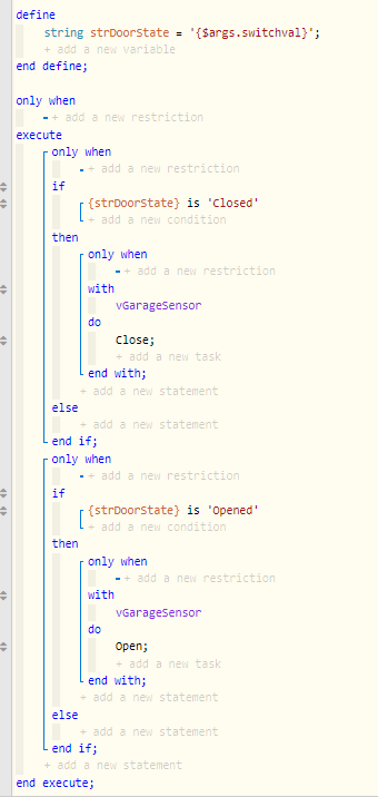

this is code from a IFTTT call I made, switchval was what was passed
edit : never mind, see you got var, just can’t convert to a time var

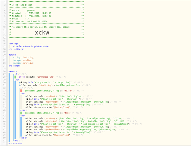

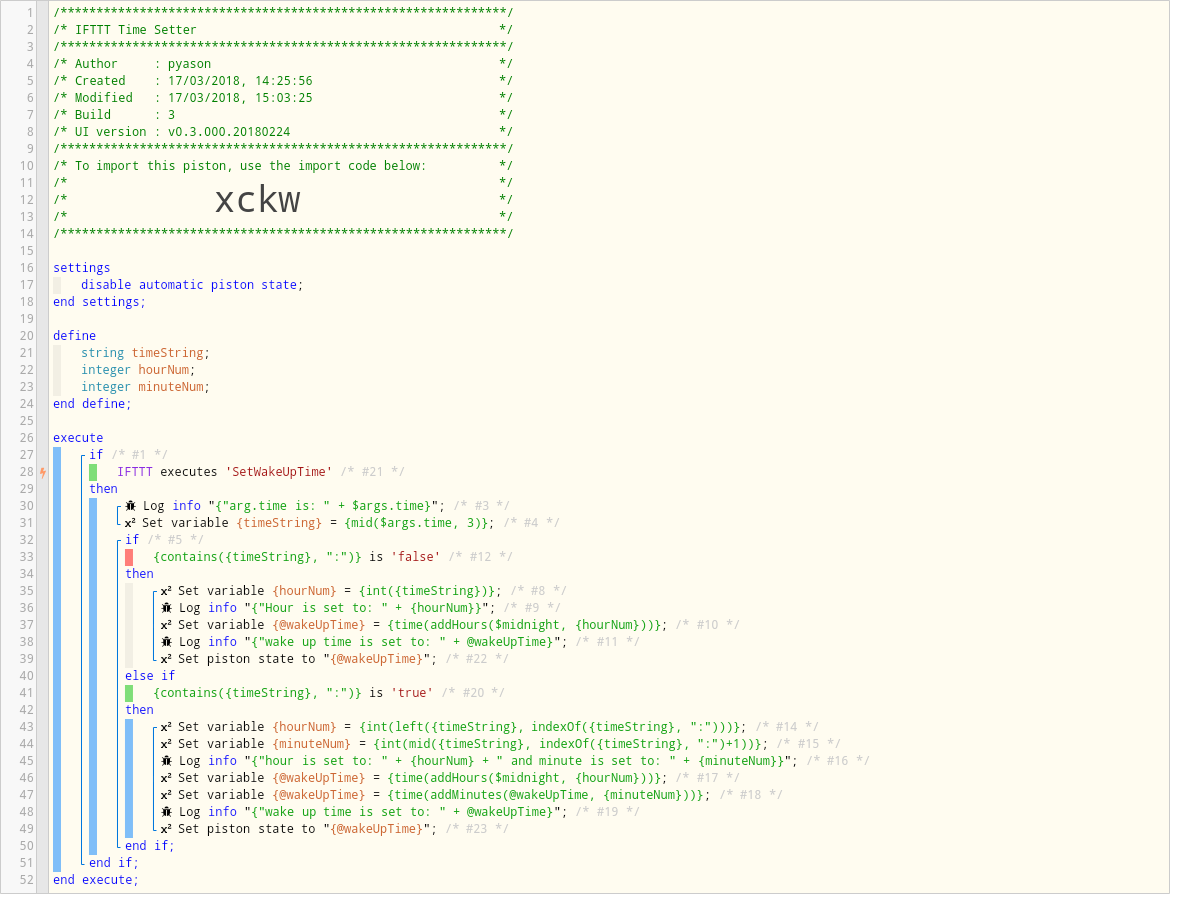

Just wanted to do similar function to set my wake up time for lights automation, did a little bit research on the forum and took inspiration from @John68, finally I came with this:

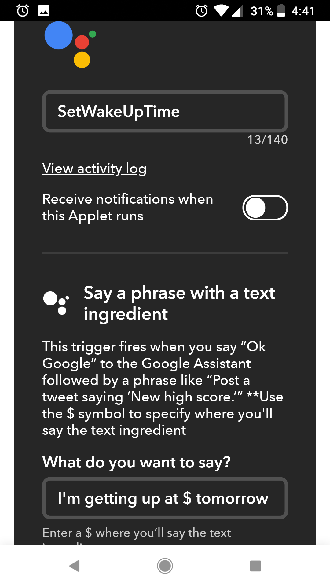

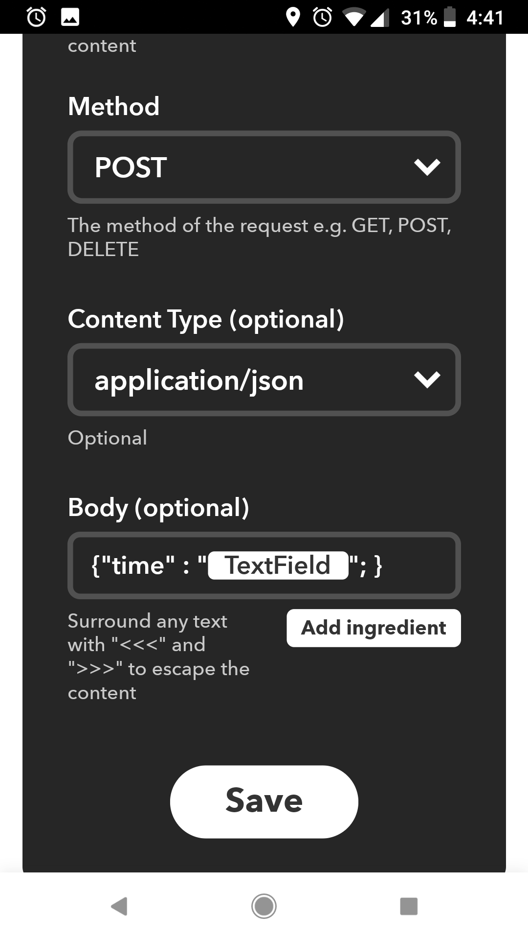

And in ifttt:
First I tired with saying numbers in ifttt, but it turned out that ifttt can’t recognize time numbers like 7:15. So I switched to phrases and parsed the string inside the piston. Finally setting to my global variable wakeUpTime.
