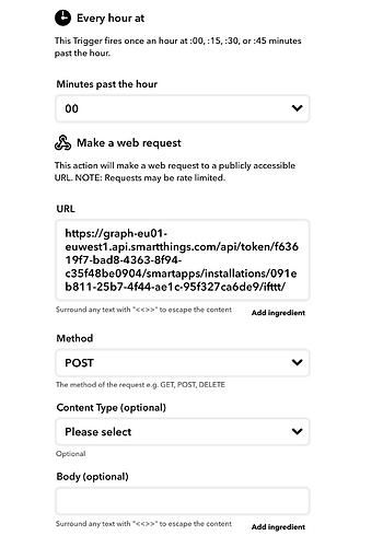

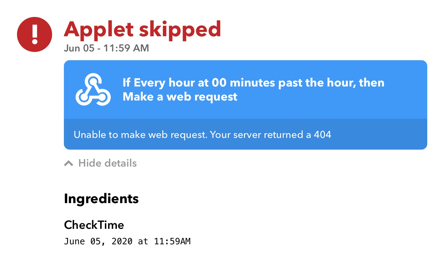

I feel like I’ve set everything up correctly in IFTTT but every time it fires to trigger my Webhook I get a 404 error.
Can anyone see anything wrong with my setup? (I slightly changed the URL for the purposes of sharing by the way)

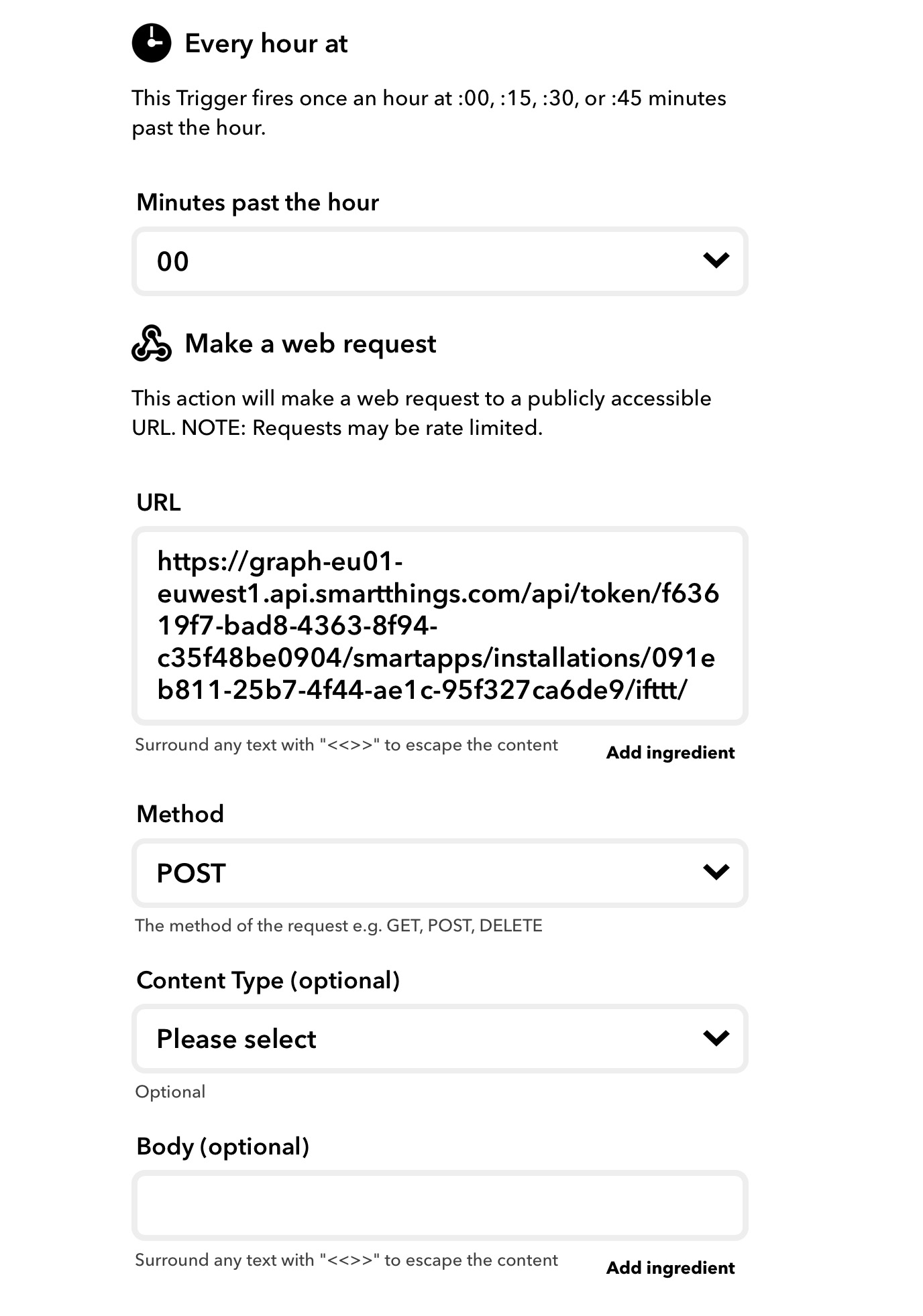

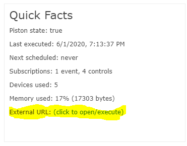

Just to confirm you are using the external URL found under quick facts?
Try putting your URL in a browser window and see what the response is. Assuming it works then only other suggestion is to change your method to GET.
I didn’t realise you had to give the URL a “value” in the piston, I thought that was for further refining but it doesn’t work at all unless you give it a simple value. Sorted now.
