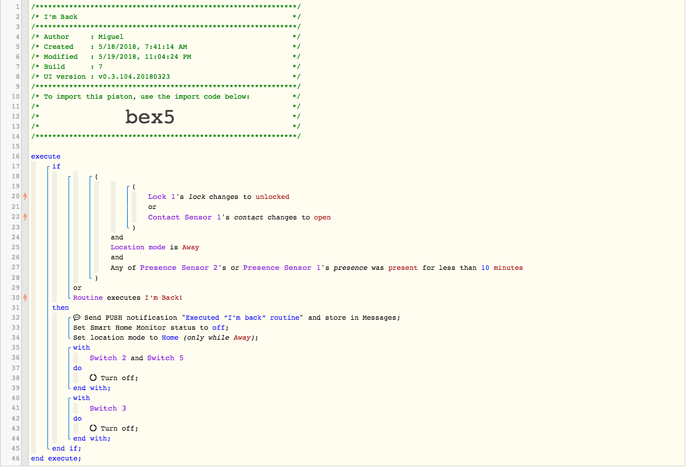

My I’m back routine did not execute when we returned home today. I know that i have some mistakes like the fact that i am re-running the I’m Back routine in my piston after i am also using it as a way to trigger it, but i don’t expect that to be the problem
The expected result is my alarm system should change and mode should change to home. While the other switches named ‘Home’, ‘Away’, and ‘Night’ are virtual switches that are used by Stringify to keep Stringify in sync with the modes.
Not happening: the alarm did not get removed and the mode has not changed. I don’t follow the logs. I want to have it change when we open the garage door which has a door sensor and IF we arrived in the last 10min (based on our phones) AND IF location was currently away then I want it to change. This did not happen
