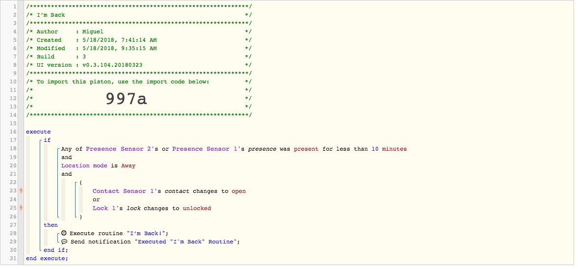

I'm Back routine didn't send notification don't know where to debug
I have a pretty simple I’m Back piston that executes the I’m Back routine in ST. This piston did not send any notification to my phone.
I expect to get a notification
What is happening: It seems that the I’m Back routine did run this first time that it run as the Smart Home Monitor changed to Disarmed and the mode changed to Home
What is NOT happening: No notification was received

Well this has got to be the dumbest post. I used Notification instead of PUSH. Still though why didnt i get any text? I think i read that Send Notification should send me a text?
I also want to add that I’m getting a lot of activity on my log where I get an “event processed successfully” every time I open garage door or unlock front door. I’m not sure if it’s actually running this piston each time when it should trigger fully only when the trigger starts but the other conditions are met. Is this normal behavior?
SMS notification sends a text message
Push notification sends a message through your mobile device notifications
Send Notifications sends a message to the Notifications in the More tab
I don’t even receive a notification if the app is open. You have to go to the Notifications menu to view them. These are pretty “quiet”.
