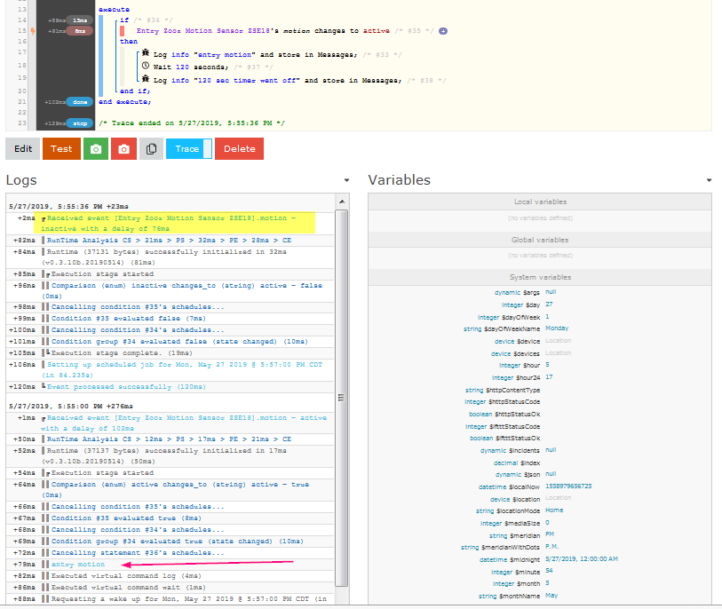

I’m trying to learn how wait is supposed to work by taking the simplest possible piston and testing
I expect to see the 120 second timer message
the timer is getting cancelled by the message from motion sensor going inactive - this doesn’t make sense because going ACTIVE is the trigger
logs above
This piston is subscribed to your sensor’s motion. This means when the motion changes in either direction (active or inactive) the piston runs top to bottom, and executes any code that is allowed by conditions.
In this case, the changing to inactive activates the piston again, but due to line 15, it does not run any of the code. It simply cancels the previous wait. This is normal, and usually preferred.
If, on the other hand, you want the remaining code to complete regardless of circumstances, then the WITH on line 17 can have Task Cancellation Policy set to Never.
