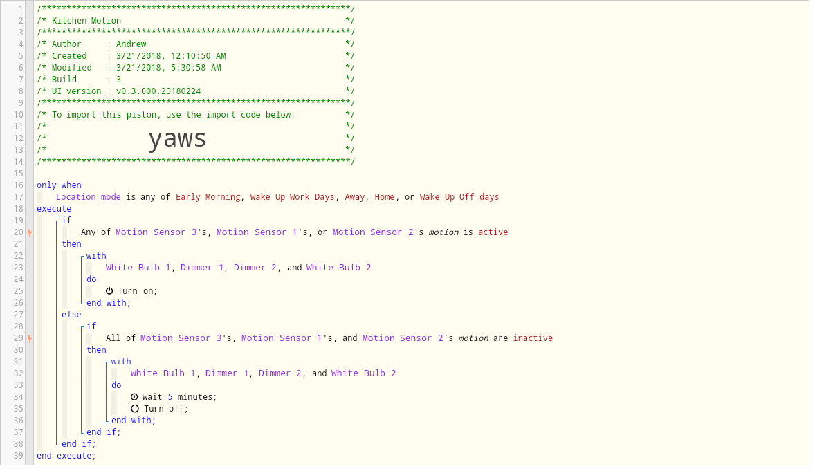

Motion is turning on the lights but no motion is not turning them off
It was working until the last outage with ST. After no motion 5 minute wait then lights turn off.
Lights turn on OK with motion but after no motion the 5 minute wait does not countdown and lights don’t turn off.
Just change the top tasks to.
Turn on.
Wait 5 minutes.
Turn off.
The go into the settings for the top IF and set TCP to never.
Then delete the ELSE IF.
