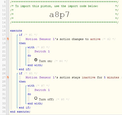

Ive just started using Webcore
I have a piston that when a motion sensor is active it turns a light on waits 5 min turns light off.
I would like
Motion sensor active
Turn light on
Timer starts 5 min
If motion sensor active
time resets to 5 min
timer runs out
light turns off
Im not sure how to start
Thanks Nicole
