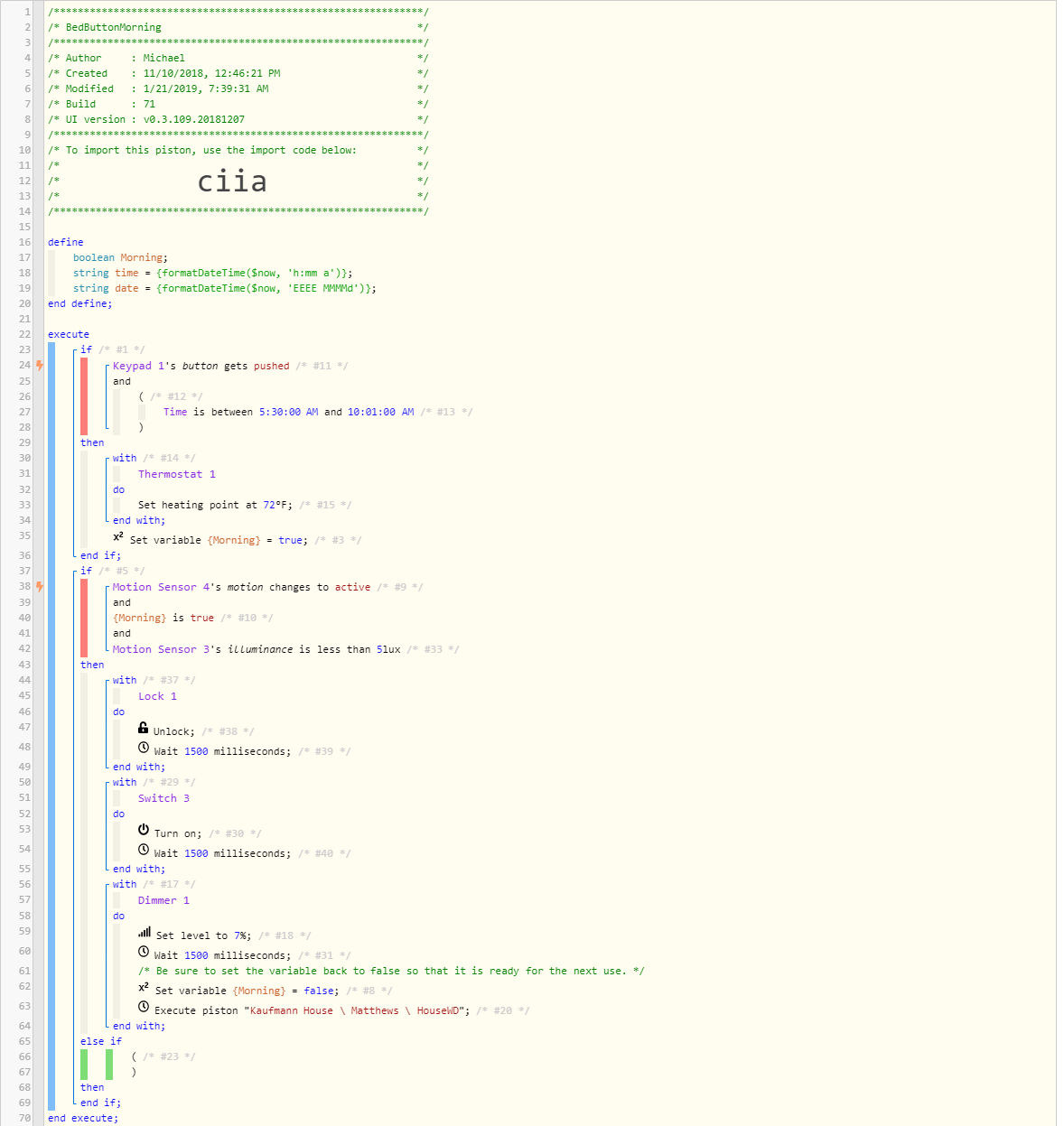

Wake up in the morning and press a button. Thermostat sets up to 72 degrees everytime. Walk out to kitchen and motion sensor should set up a series of events
(PUT YOUR INFO HERE)
The events happened as expected the first 2 mornings, then would be triggered up to 30 minutes later
