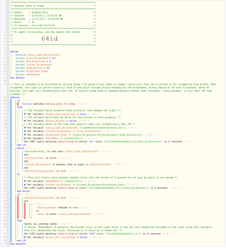

Long description: I have a piston that color cycles a light every 2 minutes to a random hue. The intent is to keep my daughter focused on a single point while I or my wife are rocking her to sleep, speeding up the sleep process a bit. (This is actually an old hypnotic method called fixed-point induction.) All that works fine.
I have a boolean variable called “Lydia_Asleep” that I use in some other lighting routines. Because we won’t be using some of the other lighting pistons regularly, it’s very possible this variable can be set to “true” when she’s actually awake. To avoid that, one of the first things I do in this piston is set the variable to false. In the 2nd “block” (where I’m basically running a 2-minute loop), you can see that if this variable changes from false to true, it will cancel the loop. That part works.
In the third block, you can see that it’s specifically waiting for this variable to become “true.” When I run the ST routine that sets it to true, the loop stops, as it should, but the next part doesn’t run. According to the log, it was evaluated as false. I’m confused as to how two parts of the same piston can evaluate the same variable two different ways at the same moment.
To add to that, since the 3rd block evaluates incorrectly, if I set “Lydia_Asleep” to false (part of another lighting piston), it starts the 2nd block back up and resumes the color cycling. Incidentally, that also showed me I can preset a LIFX light to exactly what I want without turning it on. Good to know.
The condition should be evaluated as true when I change the variable to true.
Condition not evaluating correctly.
This was after I set the “Lydia_Asleep” variable to “True.” (Condition #19)
5) Attach any logs
This was also after I set the “Lydia_Asleep” variable to “True.” (Condition #19)
‘|+0ms |╔Received event [The Bull Homestead].:6af3b6cfbce7661df2d53986340160eb: = @Lydia_Asleep with a delay of 90ms|
|+304ms |║RunTime Analysis CS > 24ms > PS > 179ms > PE > 101ms > CE|
|+317ms |║Runtime (50463 bytes) successfully initialized in 179ms (v0.2.0ff.20171129) (316ms)|
|+317ms |║╔Execution stage started|
|+324ms |║║Comparison (string) null executes (string) :835b57e99e5e99197d92f8651702614b: = false (2ms)|
|+325ms |║║Condition #13 evaluated false (4ms)|
|+326ms |║║Condition group #1 evaluated false (state did not change) (4ms)|
|+331ms |║║Comparison (datetime) 1513018624535 is_less_than (datetime) 1513021901349 = true (1ms)|
|+333ms |║║Condition #12 evaluated true (4ms)|
|+336ms |║║Comparison (boolean) true is (boolean) false = false (1ms)|
|+337ms |║║Cancelling condition #14’s schedules…|
|+338ms |║║Condition #14 evaluated false (4ms)|
|+338ms |║║Cancelling condition #8’s schedules…|
|+339ms |║║Condition group #8 evaluated false (state changed) (11ms)|
|+344ms |║║Comparison (boolean) true is (boolean) true = true (1ms)|
|+345ms |║║Condition #35 evaluated true (4ms)|
|+348ms |║║Comparison (boolean) true changes_to (boolean) true = false (0ms)|
|+349ms |║║Condition #19 evaluated false (3ms)|
|+352ms |║║Comparison (datetime) 1513018624556 is_after (datetime) 1513021901349 = false (1ms)|
|+353ms |║║Condition #31 evaluated false (4ms)|
|+354ms |║║Condition group #36 evaluated false (state did not change) (9ms)|
|+355ms |║║Condition group #15 evaluated false (state did not change) (14ms)|
|+357ms |║╚Execution stage complete. (40ms)|
|+421ms |╚Event processed successfully (422ms)|’
