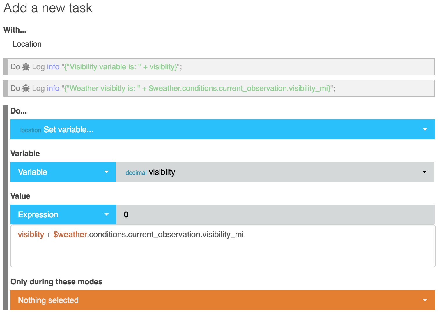

I’m trying to incriment a variable based on a value returned from a function, its always returning “0”. This is related to another post, but was advised it would be better to start a new thread. Also cleaned up the code for simplicy
Variable gets incrimented
Variable stays at 0
Here is a ss of my expression

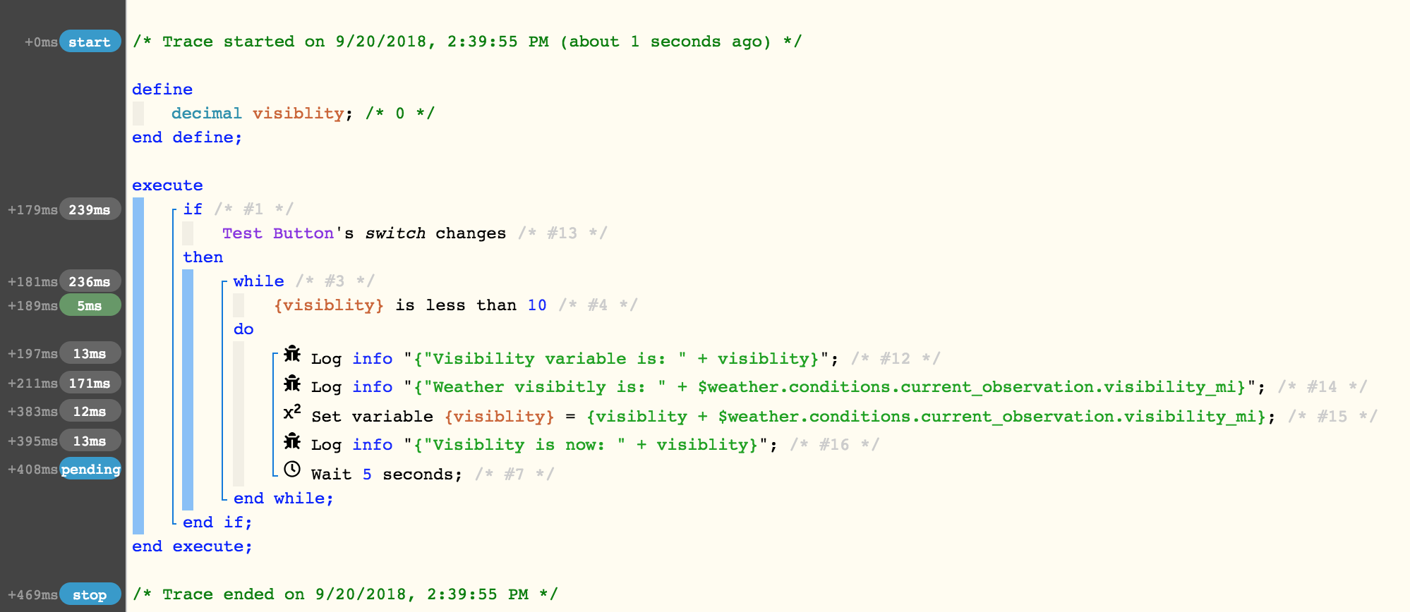

( 9/20/2018, 2:41:03 PM +91ms
+226ms ║Visibility variable is: 0
+361ms ║Weather visibitly is: 10.0
+387ms ║Visiblity is now: 0
9/20/2018, 2:40:59 PM +51ms
+198ms ║Visibility variable is: 0
+341ms ║Weather visibitly is: 10.0
+371ms ║Visiblity is now: 0
9/20/2018, 2:40:55 PM +112ms
+221ms ║Visibility variable is: 0
+386ms ║Visiblity is now: 0)
Force $weather.etc into a decimal, decimal($weather.conditions.current_observation.visibility_mi)
That did it. When I read the weather API documentation it said it “returns a decimal”, so I never considered it wouldn’t get handled properly.
