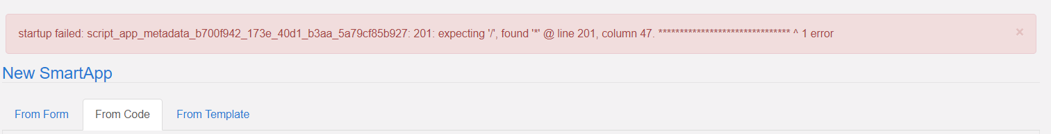

d. I get a script error when trying to install the STORAGE app.
Attempting to install the Storage app.
script error in line 201 column 47

another trick when copying/pasting of code from github is to select the Raw tab at the top of the page, then select all in your browser, copy then paste into IDE :slight_smile:
Thank You
My COPY was faulty.
