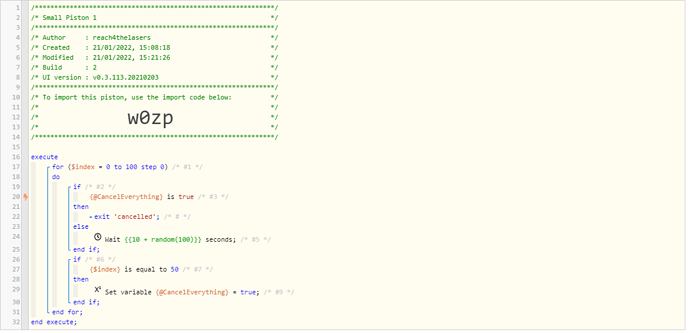

Here is a very simple example… a master piston that calls two different, but identical pistons.
These two pistons have a for loop which waits a random amount of time. I want the first piston that reaches 50 to cancel itself and the other one.

A few thoughts come to mind…
  • I would add a small WAIT in between the “execute pistons”…
  • In the other pistons, line 17 should be at least “step 1” (if you want it to advance)
  • I would likely change lines 27 to say “is greater than 50”… (Just in case of spam)
  • (optional) Instead of using $index, I prefer using a local integer variable called “i” instead. This lets me actually SEE the progression at any time.

Yeah sorry the step 0 is an error. I appreciate the input but these aren’t real pistons they’re just simple examples I threw together. My actual pistons do NOTHING like any of this.

If you want pertinent advice, it helps to see your basic structure…
I try my best to avoid semaphores… You may be the first person actually seeking them.
In my experience, SimSwitches are awesome… but your @global condition should work as well. (as long as you don’t expect an instant abort… it might take 10 seconds)

I’d probably process using a local variable, and copy it to a @global at each loop…
#11
It is worth noting that if the piston encounters a wait statement lasting more than five seconds (and in certain cases shorter ones) it will exit, thus causing any changes to globals to be written out, and when it wakes up it will cache the globals again.
Also you can subscribe to changes in globals, which your sample pistons do.
