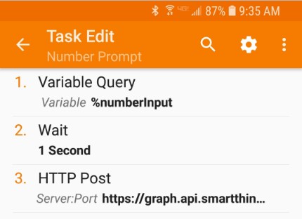

Proof of concept…
Variable Query prompts for a number, saved into %numberInput
2018-09-18_093442

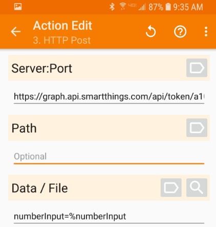

This is step 3 of the HTTP POST where the URL is the piston’s external URL. Under Data/File is the data you want to send.
2018-09-18_093538

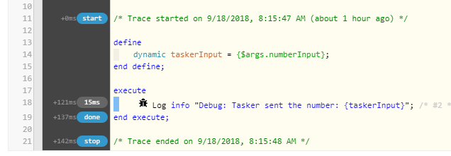

The piston that receives the info from Tasker… saved the data sent by Tasker to taskerInput variable or just use $args.numberInput directly.
