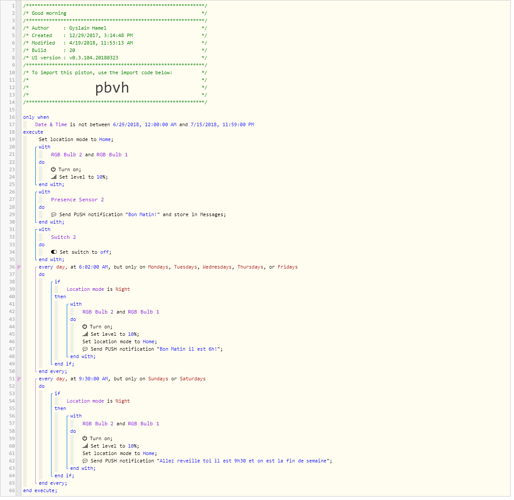

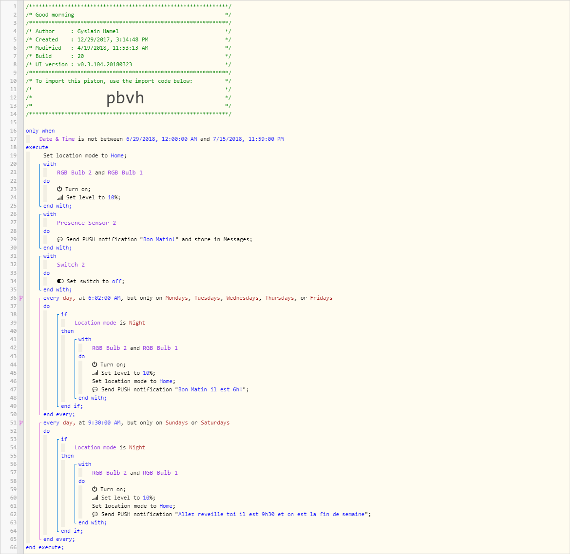

Is there a better way to do this?
So in resume this piston turns on the light in the best room at 6h02 AM during the week and at 9h30 AM during the weekend if the location mode is night.
My issue tho is i do not want that piston to run during my vacations or during holidays.

And our vaction are from June 29 to July 15 inclusively.
So I made the only when to filter the dates, is this a good way to do this or is there a better way to do this?
Thanks

But is my actual method that i posted ok?
Like will it work?
I plan to add more lines and make sure it’s a logical OR and not an AND
It looks like it should, but I would wait for one of the Webcore minions to answer.
Sorry, I’m just not an expert at Webcore myself. It looks right to me.
Not sure this will work… What is triggering the code for lines 19-35?
I see the triggers/timers for the “every day at…” but nothing for the first block of code.

I need to adjust that but for line 19-35 technicly what happens is
In another piston i have a Virtual switch that reacts when i tell Alexa good morning
So if i say Alexa Good morning, the other piston turns the virtual switch on, and change the location to home, (so then line 19-35 fire)
So that shouldn’t be an issue since i won’t be home to tell alexa good morning :stuck_out_tongue:
What if you just make the system default to vacation mode if you’re not home at 3am, or not home at 3am for the 2nd day in a row?
Because in my 2 weeks vacation i’ll still have 3-4 days straight at home
So i don’t want it to fire
I added a new line for it not to run between April 21 and April 21 2018
And sadly the rule ran this morning at 9h30 :frowning:
Not sure how to fix this
I am a newbie just so you know:)))

I think your “Only When” date restriction at the top of the piston isn’t acting on your “Do Every” weekday/weekend sections later on.

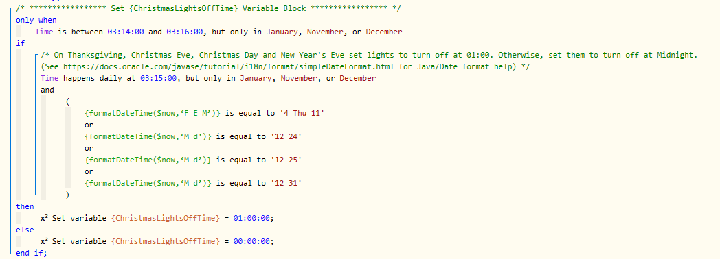

This is a section of one of my pistons that calculates the time to turn off the Christmas lights based on certain dates.
In your case, you can change the dates, add as many others as you like and also make date ranges too. Then instead of setting a time variable, have the piston that has these statements in it either pause (or not) your piston above.

It ran because there are no dates between the 21st and 21st. If you set it to “between the 21st and 22nd” it would not run on the 21st and it would resume on the 22nd.
Using ‘between’ statements you have to imagine there is an “at midnight” suffix on your date. Then it’ll work the way you want it to.
#18
Make sense i’ll try this
I though that between april 21 midnight and april 21 11h59 PM would work byt guess not
