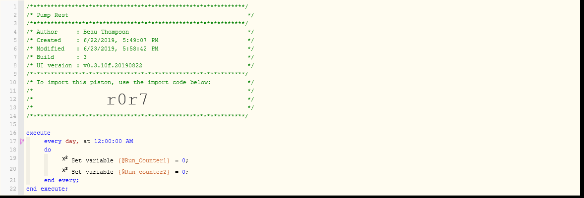

If is a statement but you ‘do’ tasks. You can put the do inside the if but not the other way around. What are you trying to accomplish?

what i am trying to do is the first time the script is run and run_counter1 = 1 i went to send the current date and time set to a variable called firstr
Global variables get set when the piston finishes execution, so @RunCounter will always lag behind by 1. (The second execution of the piston will have @RunCounter=1.)
One way around that issue is to set runCounter=@RunCounter+1 at the beginning of the piston and then set @RunCounter=runCounter at the end.

hi @qoheleth do you mean like this
where would i put the if to do the check for run count be 1 to set firstr ?
