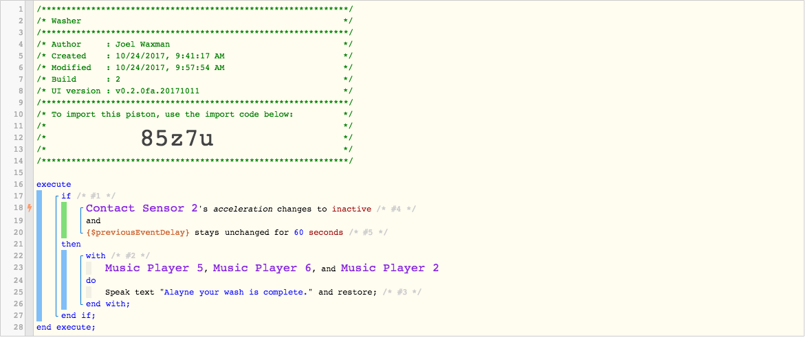

Is this the correct format, and will it work?

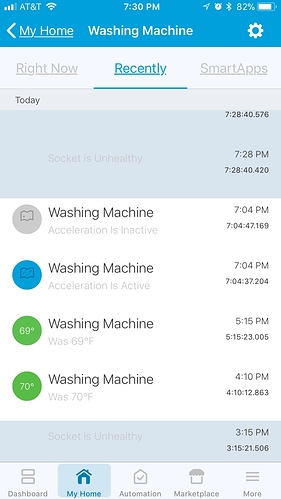

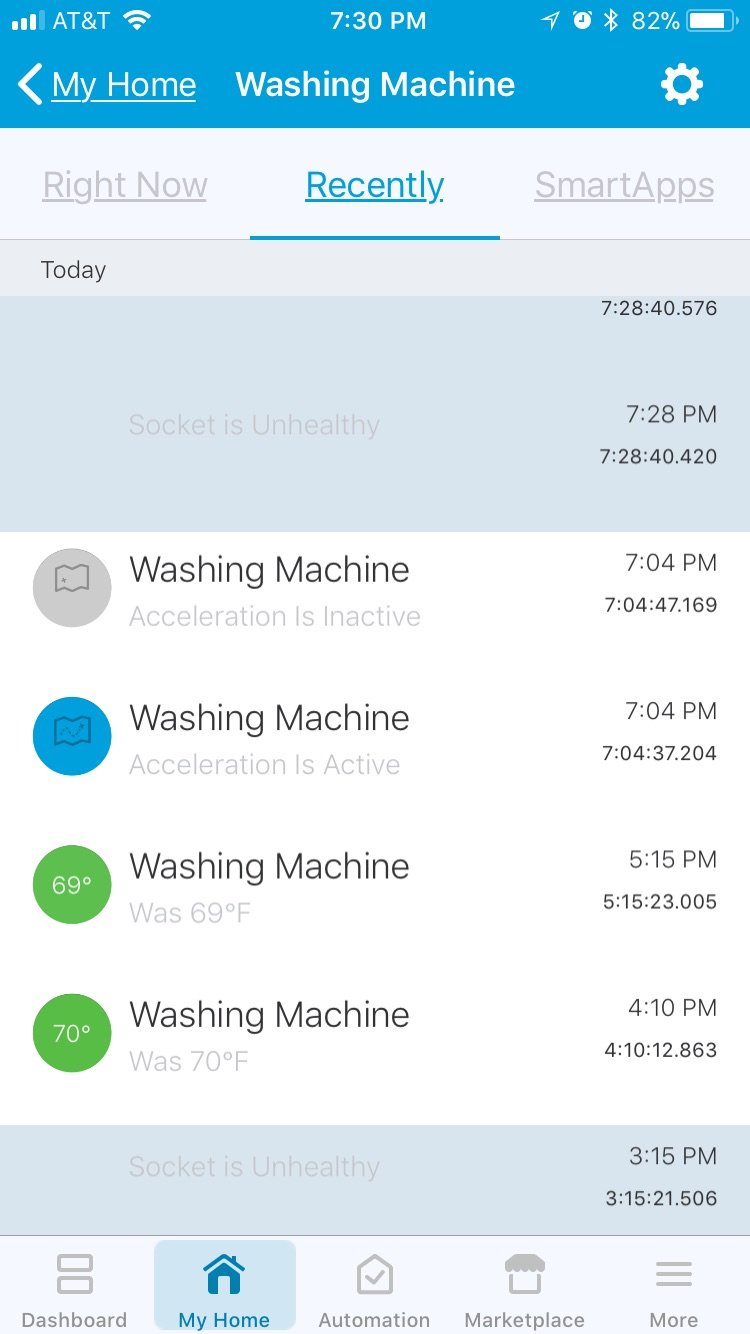

Why does acceleration shown active and inactive at the same time.
Just show inactive
Not sure if it works as it should
I’m a little confused what you are asking
I see tow times that the device shows active at the same time. Could this cause my Piston not to work, and is the piston correct to do what I want. Which is the following.
  1. When the washing machine is finished and is free of movement for 1 minute it will speak the message “Your Wash Is done” Will the Piston do that?

Ok. So what I would do is create a test piston to check some things before digging into this.
If multipurpose sensor acceleration changes
Log to console info "Currently: {$currentEventAttribute}"
End if
Then turn logging to full and run a cycle through your washer. Copy all the logs and paste them here.
