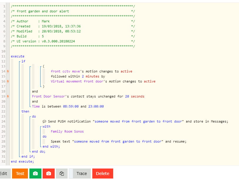

Hi Everyone, the problem I have is that I am trying to get an alert if two movement sensors are triggered within a minute of each other, and the front door sensor does NOT open within a minute of the two sensors being triggered. It needs to be setup like this so I get a genuine alert as someone approaches my house, but not to alert if that person is a family member who then proceeds to open the door and enter the house.
Expected behaviour is to alert if there is movement across two sensors but no contact opening within 20 seconds at the front door.
I never receive the alert.

A couple things… There may be a bug with the “followed by” statement that the WC team is working to fix. There’s a thread in the bug reports section regarding it…
However, even if that was working you’d run into an issue with the “stays unchanged” part of your piston. That’s also a Trigger and you’re asking for too many things to happen all at the same time for that to work properly.
Just thinking here…but perhaps a better approach would be to go something like:
IF motion B changes to Active
AND
motion A is active (as long as your timeout value is >2 minutes this will work)
THEN
Wait 20 seconds
Check to see the last time the door was opened… age(device:contact)
and if it was more than your specified time
send your notificaiton
I use something similar (minus the wait part) to turn on lights if I’m going one way in my house and not if I’m going in the opposite direction. So I pass by Motion A first, so it changes to active and stays active long enough for me to pass by Motion B…so when that happens I know which way I’m moving and I can turn on the lights in the direction I’m going.
