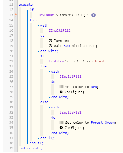

I am trying to do the setcolor and it’s not staying on, changes back to light blue right away
in logs looks like this, works in gui, but not in webcore, anyone done this before
I am just trying to use the hsm200 as a notification device, when a door is open turn green and stay green, closed turn red and stay red kinda thing
bad in webcore (not working)
31c5ba10-0171-4855-9940-a68359ea3034 11:00:38 PM: debug setColor() : [hex:#8FBC8F, hue:33, saturation:25, level:65]
good in smartthings gui (doing manually)
31c5ba10-0171-4855-9940-a68359ea3034 11:00:26 PM: debug setColor() : [red:181, hex:#B569FF, saturation:58.823532, blue:255, hue:75.11111, green:105, alpha:1.0]
looks like this works, had to add configure after change
also need to set “No Motion Interval” to 0 (zero) to disable motion detection color changes
