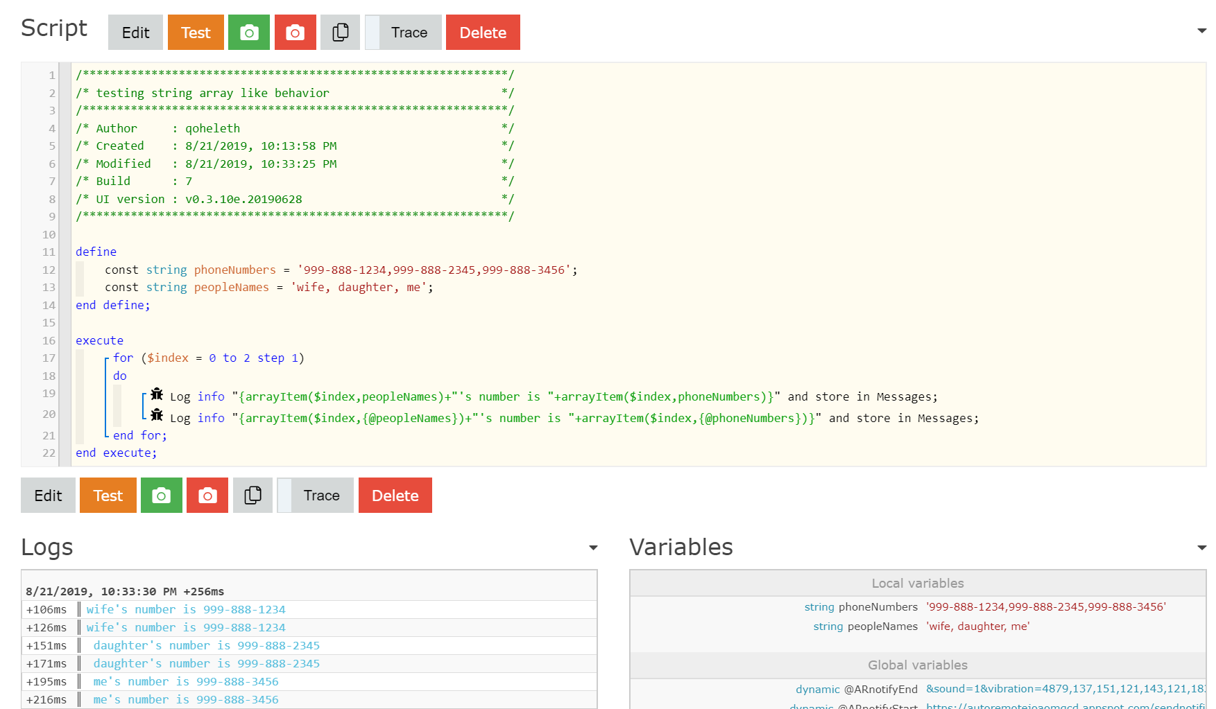

What I’ve done for a list of phone numbers is:
define
const string phoneNumbers = ‘999-888-1234,999-888-2345,999-888-3456’;
end define;
Then you can use arrayItem(index,phoneNumbers) to get the phone number you want. (I know, I didn’t expect arrayItem() to work that way either.)
BTW, I also have a string called peopleNames which gives me the first name of the person. phoneNumbers and peopleNames are in the same order as my device list.
I am curious, @qoheleth, have you tested that concept with global variables, or only with local variables?
To be sure, I only tested it on locals. Hang on… Yes. It works with both.
That really gets my creative juices flowing… Thanks for sharing!!
