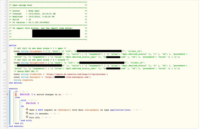

Trying to integrate a Genie Aladdin Connect garage door opener, but I am not able to activate the door via the Make a Web Request State. I have this working in Postman, and I believe the headers are getting mangled when I implement via webcore.
I am activating the piston from a Virtual Switch, then turning the switch off 15 seconds later for simplicity while I try to get the POST action working.

Actual headers:
“content-length”: “346”,
“accept”: “/”,
“authorization”: “AppVersion: 2.10.1 BundleName: com.geniecompany.AladdinConnect User-Agent: Aladdin Connect Android v2.10.1 BuildVersion: 131 Content-Type: application/json Authorization: Basic ljkasdfljasdflkjasdlfkjalsdjf”,
“content-type”: “application/json”,
“user-agent”: “Apache-HttpClient/4.5.2 (Java/1.7.0_201)”,
“accept-encoding”: “gzip,deflate”

|10/2/2019, 7:35:50 PM +141ms|
|+2ms|╔Received event [Home].time = 1570062951781 with a delay of -1640ms|
|+195ms|║RunTime Analysis CS > 47ms > PS > 111ms > PE > 37ms > CE|
|+197ms|║Runtime (42494 bytes) successfully initialized in 111ms (v0.3.10f.20190822) (195ms)|
|+198ms|║╔Execution stage started|
|+230ms|║║Executed physical command [Garage Open].off() (13ms)|
|+231ms|║║Executed [Garage Open].off (17ms)|
|+233ms|║╚Execution stage complete. (35ms)|
|+235ms|╚Event processed successfully (234ms)|
|10/2/2019, 7:35:36 PM +205ms|
|+2ms|╔Received event [Garage Open].switch = on with a delay of 103ms|
|+129ms|║RunTime Analysis CS > 21ms > PS > 74ms > PE > 34ms > CE|
|+131ms|║Runtime (42494 bytes) successfully initialized in 74ms (v0.3.10f.20190822) (128ms)|
|+132ms|║╔Execution stage started|
|+139ms|║║Comparison (enum) on changes_to (string) on = true (0ms)|
|+141ms|║║Cancelling condition #2’s schedules…|
|+142ms|║║Condition #2 evaluated true (5ms)|
|+143ms|║║Cancelling condition #1’s schedules…|
|+143ms|║║Condition group #1 evaluated true (state changed) (7ms)|
|+145ms|║║Cancelling statement #3’s schedules…|
|+155ms|║║Sending external web request to: mikedeal.free.beeceptor.com|
|+570ms|║║Executed virtual command [Garage Open].httpRequest (416ms)|
|+574ms|║║Executed virtual command [Garage Open].wait (0ms)|
|+575ms|║║Requesting a wake up for Wed, Oct 2 2019 @ 7:35:51 PM CDT (in 15.0s)|
|+579ms|║╚Execution stage complete. (447ms)|
|+581ms|║Setting up scheduled job for Wed, Oct 2 2019 @ 7:35:51 PM CDT (in 14.996s)|
|+589ms|╚Event processed successfully (589ms)|
