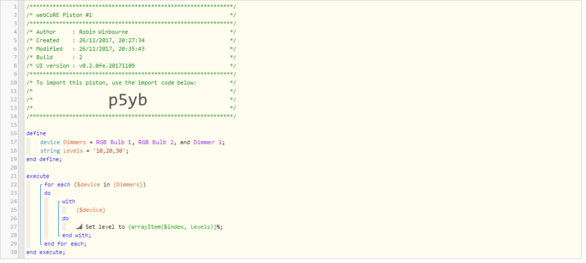

This should send you in the right direction:
List your devices in the ‘Dimmers’ variable
List you levels in the ‘Levels’ variable, comma separated in the same order as the devices.
array( 0, variableName) returns the first item in the comma separated list
array( 2, variableName) returns the third item in the comma separated list
array( $index, variableName) returns the ‘for each counter’ item in the comma separated list
In the example above:
RGB Bulb 1 = 10%
RGB Bulb 2 = 20%
Dimmer 1 = 30%
