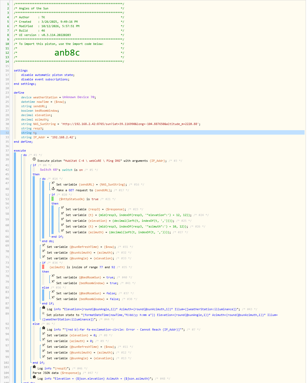

I cannot get JSON parsing to work.
string variable = {$json.elevation} after doing a Parse JSON Data statement
The data is always blank
Here is the Full log for the part of the piston that is trying to use JSON data. The $response data is at +132ms
+130ms ║║Executed virtual command setState (0ms)
+132ms ║║{“altitude_m”:1609.0,“azimuth”:256.3974,“delta_t_s”:75.56,“elevation”:4.5091,“elevation_true”:4.363,“is_up”:true,“latitude”:39.11699,“longitude”:-104.9903,“pressure_pa”:83431.0,“time_utc”:“2026-10-12T23:58:05.800686+00:00”,“zenith”:85.4909}
+134ms ║║Executed virtual command log (3ms)
+136ms ║║Executed virtual command parseJson (1ms)
+137ms ║║Calculating (string)Elevation = + (string) >> (string)Elevation =
+137ms ║║Calculating (string)Elevation = + (string) Azimuth = >> (string)Elevation = Azimuth =
+138ms ║║Calculating (string)Elevation = Azimuth = + (string) >> (string)Elevation = Azimuth =
+139ms ║║Elevation = Azimuth =
+140ms ║║Executed virtual command log (2ms)
+141ms ║╚Execution stage complete. (127ms)
also, here is the Webcore version I’m running:
@Field static final String sVER=‘v0.3.114.20220203’
@Field static final String sHVER=‘v0.3.114.20240115_HE’
@Field static final String sHVERSTR=‘v0.3.114.20240115_HE - August 8, 2026’
