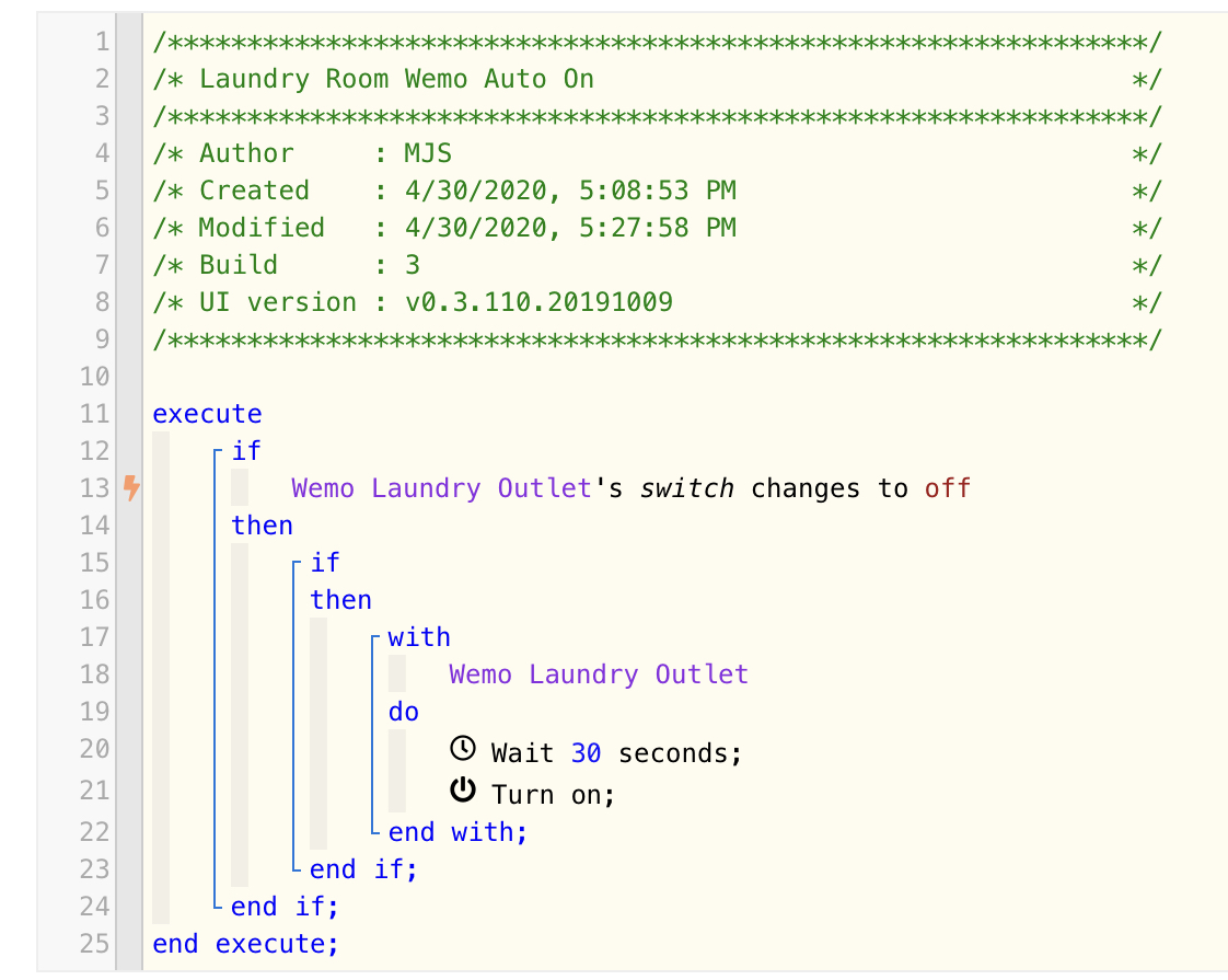

You got an extra if in there. Line 15. It’s never true so it never executes.
Move 17 up to 15 and delete the IF
Thank you so much. I’m new at this so I couldn’t even follow your directions but I changed the whole piston to this, and it worked. I really appreciate your help

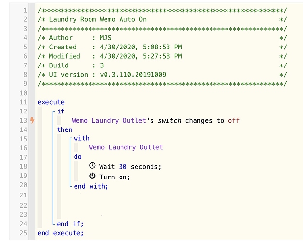

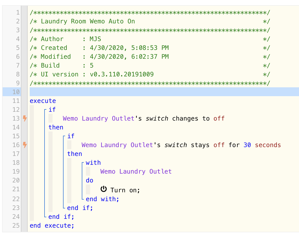

Just an observation…do you want your Wemo Laundry Outlet to turn on EVERY TIME it turns off for 30 seconds? That is what you have with this piston.
I’ve noticed that from time to time (or with a power failure) the Wemo I use to notify me that the washer has completed and then sends me an alert, will turn off. I never want it to be off, because the wife then thinks the washer is broken
. The only problem I see now is that it takes a long time for the piston to poll the wemo and therefore it is not turning the wemo back on as quickly as I’d like.
Hmmmm, your piston should trigger as soon as the outlet turns off. Do you have something else acting on the outlet (perhaps another piston or a routine somewhere)? Have you checked the logs in SmartThings to see what happens when it turns off and on and what the timing is?
If you want it turn ON as soon as turns off, why 30 second rule?
