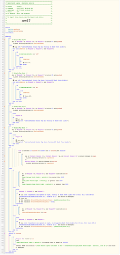

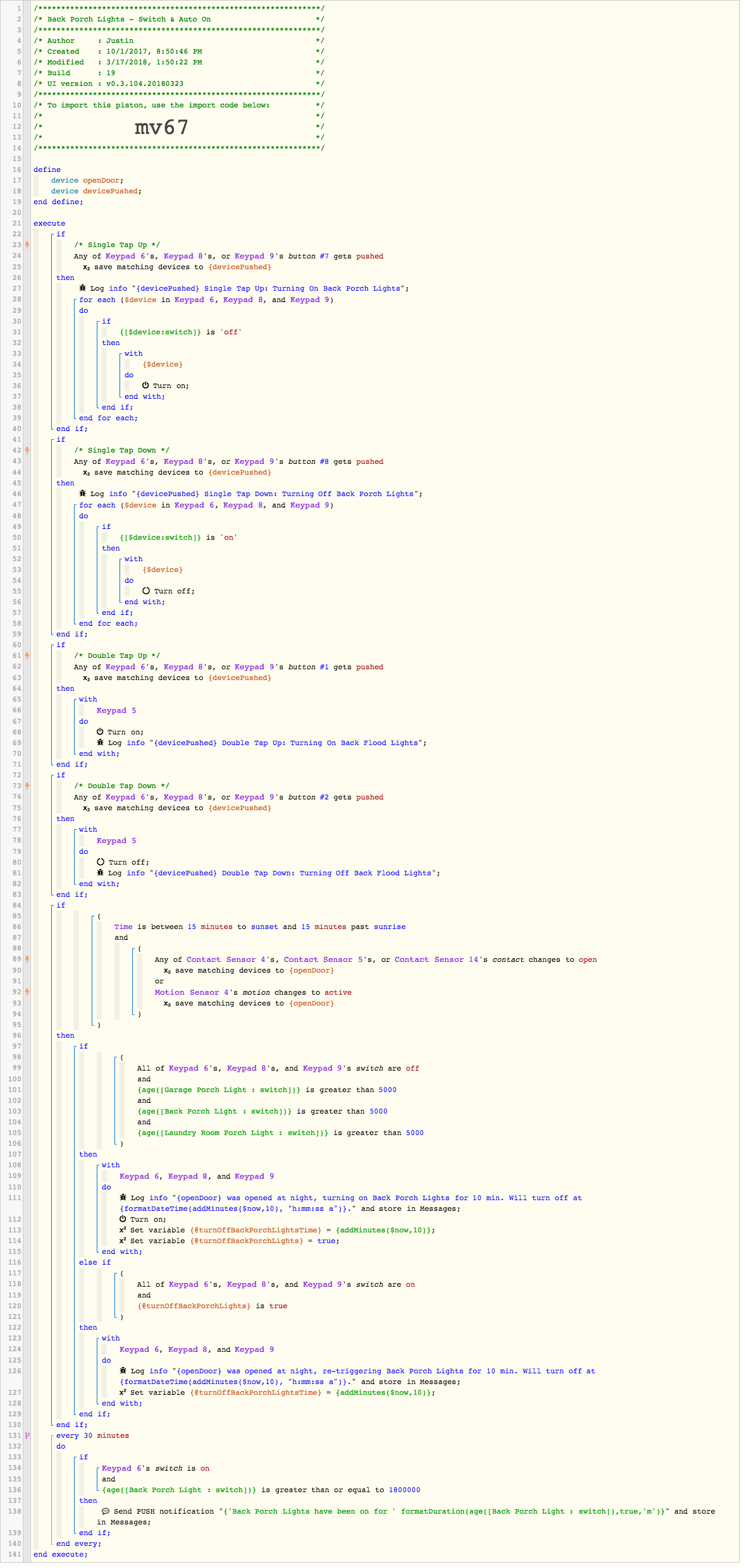

I have 3 HomeSeer WS100+ Switches controlling 3 separate lights on my Back Porch. I’d like to use a Piston to keep them in Sync so that all turn on and off together. I’ve tried multiple different methods but they always seem to work fine some of the time and then get into these chase light sequences where they turn on and off chasing each other for a few minutes. This typically happens if a user hits on and then off (or vice versa) too quickly.
Looking at the logs, it is also very inefficient. Both the inefficiency and the chase effects are likely due to the piston essentially being recursive.
Keep all 3 switches in sync.
Gets into chasing lights cycling on/off for several min especially if use turns lights on then off too quickly.
