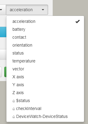

I don’t see an option for vibration. Do you mean acceleration? I am using ST multi open/close sensor on the door.
Capture
Yes I believe it is acceleration
