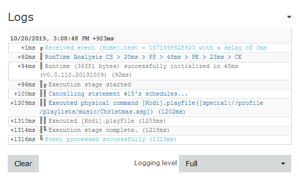

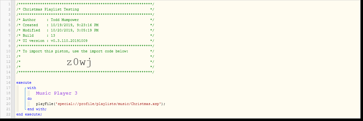

Trying to play a playlist in Kodi by using playFile
I have created a Smart Playlist Christmas.xsp that I am trying to get Kodi to play with a JSON call.
Will not play.
This is the log error from Kodi :
DEBUG: JSONRPC: Incoming request: {“jsonrpc”:“2.0”,“method”:“Player.Open”,“id”:1,“params”:{“item”:{“file”:“special://profile/playlists/music/Christmas.xsp”}}}
ERROR: Open - error probing input format, special://profile/playlists/music/Christmas.xsp
