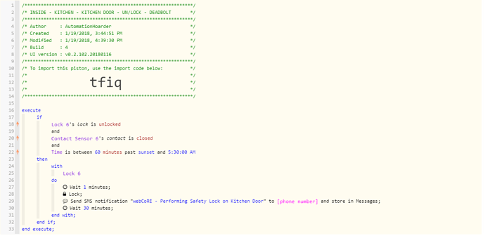

When it is night time, and the door is closed, then lock the lock, if the lock becomes unlocked, wait a period of time and then re-lock, re-check after certain time period.
The lock is locking when the door is open immediately after I open it. If I go through the door then I want it to weight for at least X number of minutes before it relocks, I also then want it to wait Y period before re-checking if the door is unlocked. Before it does anything it needs to ensure the door contact sensor is truly closed.
