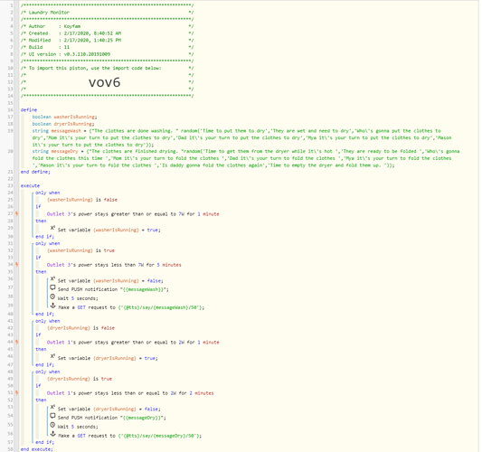

Based on some other pistons, I put together a piston to alert when laundry is done washing or drying. I have changed around the piston a couple different ways and it works perfectly. My only concern is I see continuous messages in the logs stating “Piston waited a semaphore of *** seconds”. I am wondering if my piston is just not written correctly or should be written more efficiently.
Piston working as expected but logs are concerning.
Semaphore log messages seen.
I turned on logging but haven’t done laundry again yet so no good logs to upload.
Any time we subscribe to a device’s power, we can expect that piston to be running all day, every day. (since power fluctuates nearly non-stop)
Essentially, when a piston is running, but a new trigger comes in, the piston will use a semaphore delay to wait approx 10 seconds… Hopefully, this will give enough time for the first instance to complete, so the logic can run thru the code top to bottom… yet again.
This means while the piston is running, you can practically guarantee that it will try to run again and again. Constantly waiting for the time to expire / cancelling / resetting a new timer etc…
In your case, it will be doubly bad, since this piston is monitoring two device’s power…

If you set your logging level to Full, you will likely be amazed at just how much commotion those triggers are causing. (unless your devices have inaccurate/vague power sensors)
Thanks for the info. You’re right, I did turn on logging and there is a lot going on. I understand what you’re saying about the piston trying to run over and over during its course. It makes total sense.
Maybe I’ll make two pistons instead of one. That should help a little.

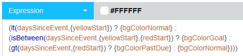

This may surprise you, but I use ELSEIF in Expressions all the time…
pic
IF Less than A, then X,
ELSEIF between A and B, then Y,
ELSEIF greater than B, then Z, ELSE X
It is just so rare to see it used properly in the body of a piston…
