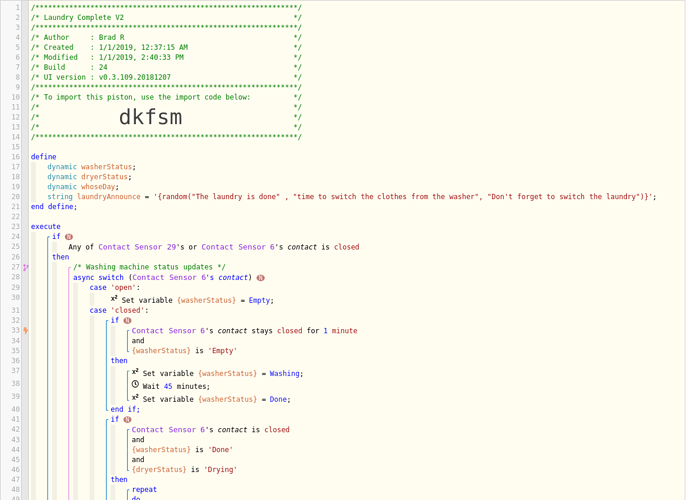

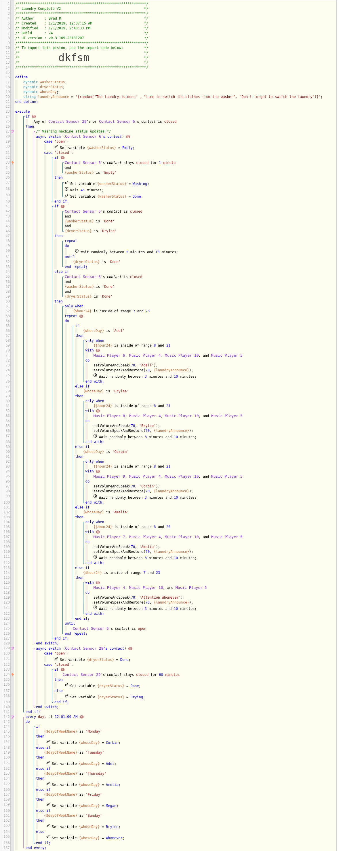

Not a problem, it works as expected, though I feel it could be much more efficient. The only piece that is a littl off is having Alexa announce the name in one command, then the random laundry message in another.
A tilt sensor is laundry washer lid and an open close sensor is on the dryer. If they washer stays closed, it starts a timer for 45 minutes(washing cycle) and then will repeat an announcement to the defined Alexa devices using Echo Speaks until the washer is open. If the dryer is not open, or not been closed for 60 minutes (drying cycle) then it will wait to make the announcement. Depending on the day, it will announce the persons name whose laundry is supposed to be being done that day.
As stated above, it does work, though I think it could be more efficient.
Thanks for any recommendations.
