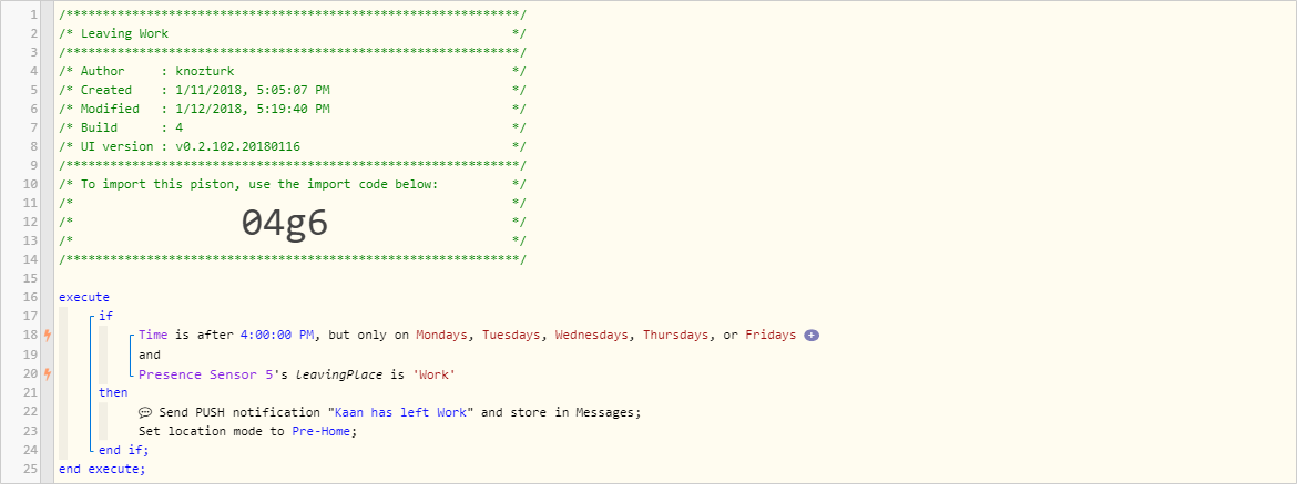

Leaving work with webcore presence sensor
It is not triggering the piston when I leave the work
It is supposed change the home mode and send a notification when I leave the work
(PUT YOUR INFO HERE)
Can you post logs to show what’s happening? The piston itself looks straight forward enough.

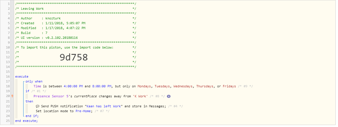

Try using "presence sensor 5’s currentPlace changes away from ‘Work’
I’m using a similar piston and the “currentPlace changes away from” performs as expected.
-rak
That’s exactly what I use and it works flawlessly.

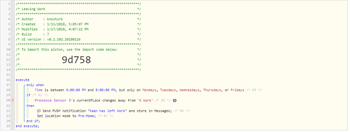

This is what I changed to
Let’s see it will work tomorrow.
