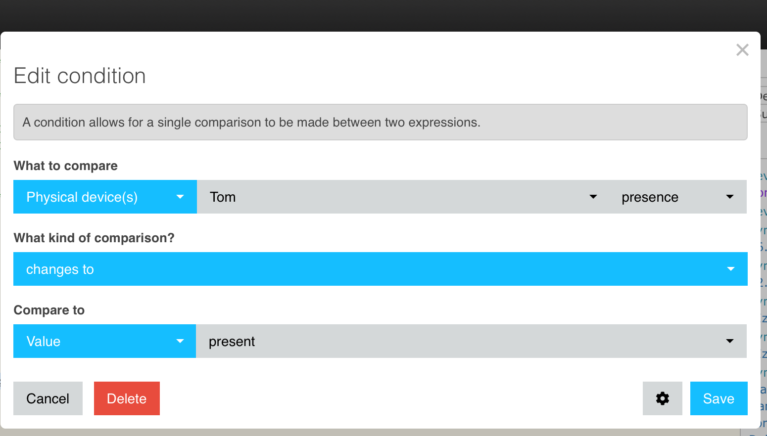

Have you gone into the webcore automation section in smartthings app and added them as devices shared with webcore?
Smartthings app >> automation >> webcore>> settings >> available devices >> available device >> pick this devices you want webcore to use.
Then hit done, done done done save.
From there they should now be available to use in webcore.
