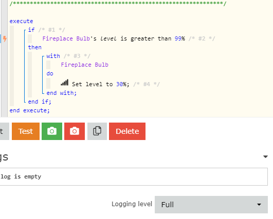

I often take a totally different route…
The logic below works IF the bulbs come on FULL brightness when first powered on.
pic
The only extra thing to keep in mind is that ALL other programming for that bulb should NEVER set the level to anything above 99%. (you should make those small changes before importing my piston)

That sounds like a great approach. Unfortunately the Lifx bulbs had a firmware update that keeps them at the same level when they power up that they were at power down.
I have switched my efforts to a Hue bulb I have never used before. It works with Zigbee, easily configured in Smartthings without the Hue app (no Hue hub). It does come on at 100% regardless of where it was set when turned off. Unfortunately, my piston never executes. Note that I have verified that the classic smartthing app sees it at 100% when powered up, and I can change the brightness from the app.
