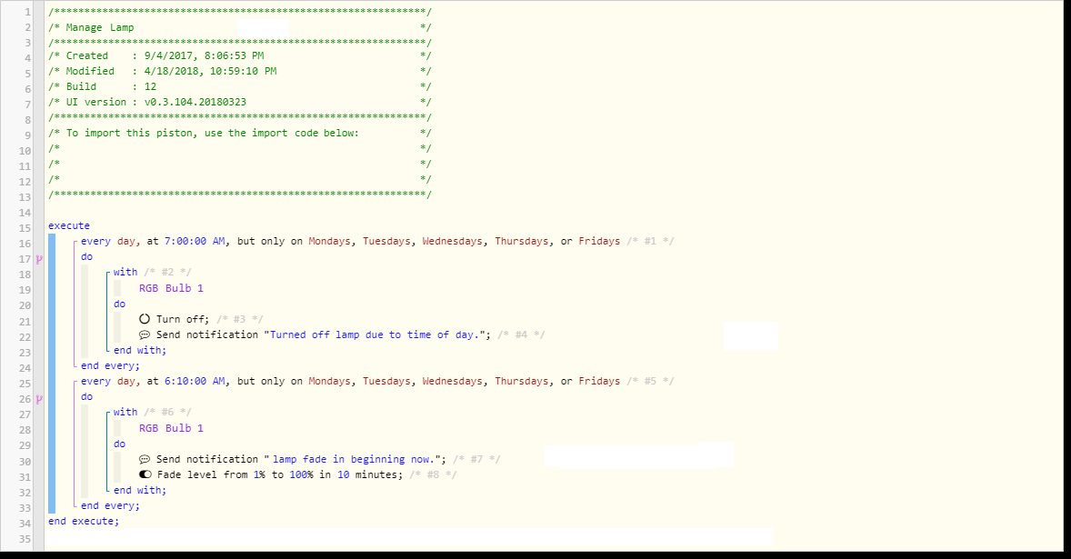

I’ve had a piston that on every weekday at a certain time makes a LIFX light turn on dim and increase in brightness from 0 to 100% over a 15 minute period, and then an hour later it turns the lamp off. That has been working great for nearly a year. The other day it stopped working, even though I can see in the webCORE logs that webCoRE is telling the lights what to do, such as:
Executed physical command [Main Lamp].setLevel([47]) (218ms)
Executed physical command [Main Lamp].setLevel([55]) (204ms)
Skipped execution of physical command [Main Lamp].off([]) because it would make no change to the device. (4ms)
Executed [Main Lamp].off (6ms)
Executed virtual command [Main Lamp].sendNotification (10ms)
Execution stage complete. (41ms)
The only thing I can think of that changed is that a few days ago I updated webCoRE and its 4 components within the SmartThings IDE to the latest version of webCORE. I had been using an older version. I did not make any changes to the piston whatsoever.
Light turns on dim, fades in, turns off later.
Light is not turning on at all. I can use the LIFX app to manually turn the lamp on and off and set its brightness just fine. Also other pistons I have that turn other LIFX lights on and off based on virtual switches are working just fine.
Image of piston is attached.

The above is a snippet of the logs. Basically log repeats what is listed above every 6 seconds, except for the part at 6:19:58 AM which is supposed to turn the light off.
Also as a test when the light did not come on and did not change in intensity, despite all the log entries showing it is changing the light, I manually put the light on. Then when 6:19:58 AM came around the log showed it sent the Off command to the light, but it stayed on.
