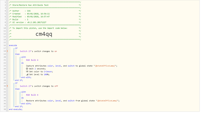

I’m trying to save some attributes of a Hue light to a global variable when a switch comes on, and then restore them when it goes off. I can get the level to work, but the color isn’t being restored.
I tried adding a wait statement, thinking I just needed more time to save the attributes before changing the light, but it didn’t help. Am I just missing something? Seems pretty straightforward, but can’t make it work.

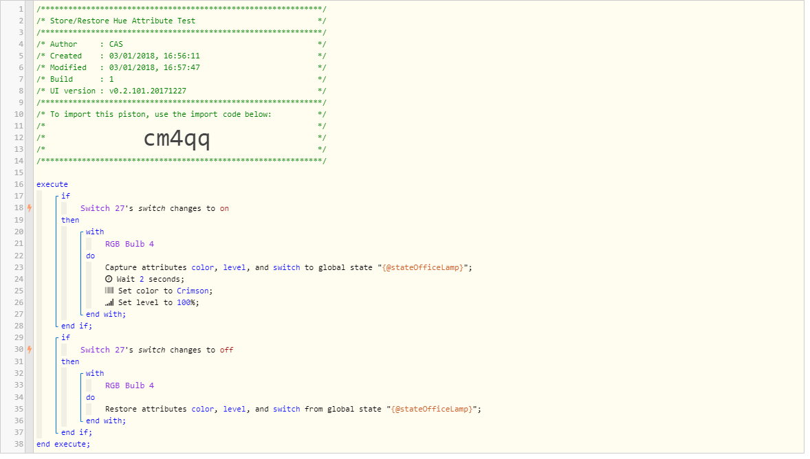

Try restoring color only. If it works, then try capture HSL value and restoring that.
Edit: keep the wait
Looks like it works when I capture and restore HSL… just not color.
Thanks much!
It essentially breaks down as this
color == H/S/L == hex
Problems occur when you start mixing them together
