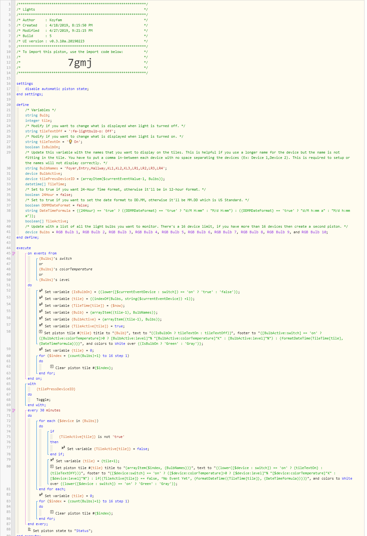

I setup the light status tiles piston a few weeks ago and think it may be causing some issues with my LIFX bulbs.
The tiles should update when a change is detected or after 30 mins.
I noticed during my light automations specifically during a fade cycle that my bulbs would randomly turn off and on a few times. I originally chalked it up to network latency but after looking at the device logs it seems the command to turn off and on is coming from the Light status piston.
“description Lights sent off command to LR Light 1”. “Lights” is the name of the piston for the bulbs status.
I had noticed my SmartThings smart plug that controls some cabinet lights was turning on and off as well during a certain time. The logs also showed the light status piston was sending the On off commands. I removed the smart plug from the piston and from webcore altogether since I don’t need to control it but I don’t know what’s going on with the lights.
I should have searched a little more. I found some threads with this exact behavior and stumbled across the solution (I hope).
@MajorEvent posted a fix late last year. Thanks!
