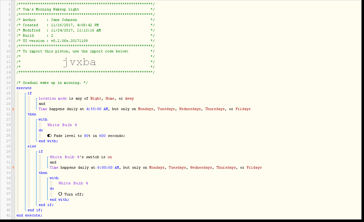

Light doesn't turn off
The light doesn’t turn off at 6:00 AM
The light turns on at 4:55 and fades up to 80% in 600 seconds then at 6:00 AM the light should turn off
The light doesn’t turn off.

I think I would break your ELSE statement out into its own IF statement.
So you have an IF statement to turn it on and a completely separate IF statement to turn it off.
All within the same piston.
OK, I will try that. Thanks!
