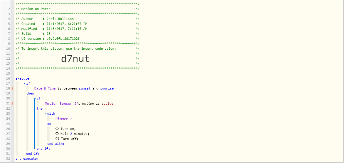

Lights not turning off after wait, should be a very simple program. I even check the device in the ide and event history doesn’t show getting the command. See it turn on, then nothing.
If motion, turn on light, after 2 minutes, turn off.
Light turns on when expected, doesn’t turn off

Just change the code to use AND.
If time is between sunset and sunrise
AND
motion is active
Then DO
Will give that a try. Sadly, can’t test it until after sunset :frowning:
Click on the word with when in edit mode.
Now click on the settings cog.
Now under Task Cancellation Policy (TCP) select never.
That will solve the problem.

I would even venture to split it into
IF motion and time
then light on
elseif: motion inactive and light on
wait 2 minutes, light off
that way if you are still in the area, it’ll still keep the light on.
of course if it’s not necessary then…
Perfectly valid statement but just for information so does the example I posted.
If motion is detected within the 2 minute countdown window the timer stops.
When it goes inactive it then starts again.
So if there is constant motion for 30 minutes the light will never turn off.
Just thought I would clarify.
