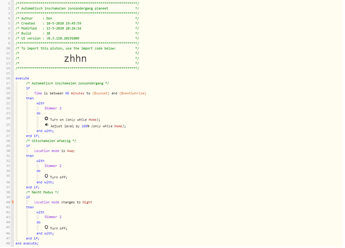

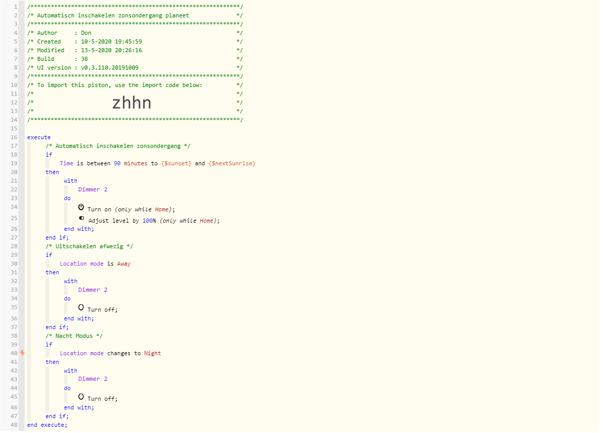

My so called ‘‘planeet’’ doesnt turn on. This is a smart light.
What I am trying to create is that the light turns on 1 hour or longer before sunset when the house is in ‘home’ state.
Somehow the light doesnt turn on when the house in in home state. However when I enable it manually it works like I designed it. When I put it on away it goes of, back to home mode and it turns on again. Like I manually have to start it right now. Also when I put it in sleep modus the light turn off.

The log above is after the house changes from away to home. Then it works fine! But when its set home and turns dark it doesn’t work.
Hope you guys can help me out with my first Piston :slight_smile:
Notice the trigger in the left margin…
This is what events will execute the piston.
(In your case, the piston will run any time Location mode changes at all)

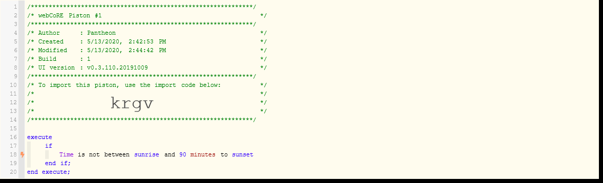

You do not have a lightning bolt (trigger) to the left of your first IF. When spanning midnight, I like to use the NOT option…
IF Time is NOT between sunrise and 90 minutes to sunset
Give that a try and see if it works.

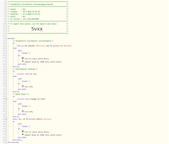

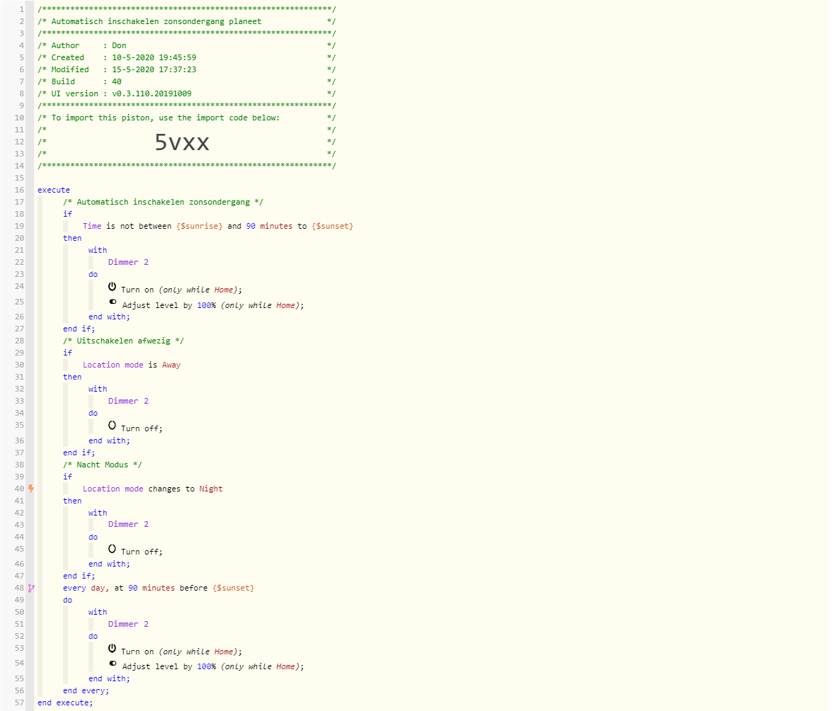

Thanks for the tip! Now I kinda understand what the trigger does. However how do I set the trigger or maybe in my case remove the trigger completly?

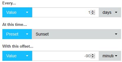

To create this logic:
add a new statement > Add a timer
Then set the popup like this:
pic
@Don, at second glance, I don’t think my suggestion will work for you. @WCmore is the expert here and I would follow his suggestions.
Tigger is still not at the right place, but this might work?

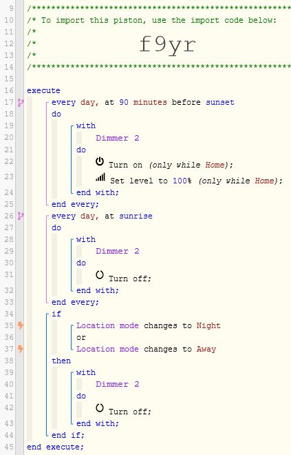

Here is a piston that does everything that we have talked about:
Note:
Due to your “ONLY WHILE HOME” logic, if you come home late (after Sunset-90m), then the Dimmer is not programmed to come on.
If you want it to, then you can add a new block to the bottom:
IF Location mode changes to Home
    IF Time is not between sunrise and sunset-90min
        Turn on Dimmer
    END IF
END IF
(that time condition is intentionally inverted)
